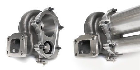

That housing will work just fine breezen. Get a divorced flange from (you can choose but I have them available) such as this:
GT Series flange

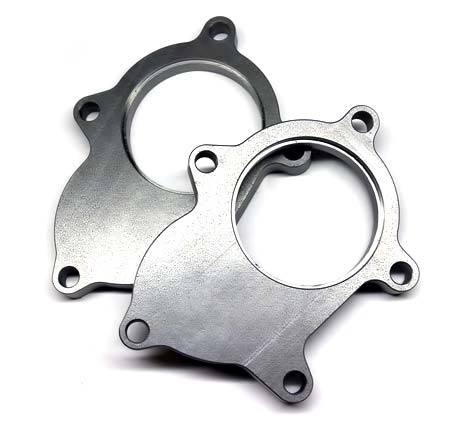

Or get a T3 series like this and drill it out (as Im not sure if the GT flange will fit your housing or not)
T3 Flange un drilled

If you're set on using an external wastegate, you could use the top flange in the pic MDC showed (the one w/ 2 pipes) and route the bottom pipe down to your wastegate. A lot like Randy's DDPs...in fact, he could likely custom make you one if you supplied the turbo flange and wastegate/flanges. Unless you wanted it to be very loud when the wastegate opens, you could even have it routed back into the main pipe. From the pics you provided, it looks like the flapper is part of the flange...a new flange without the flapper is what you would need.

Would it definately need to be welded?,:icon_conf or would bolting it down do it? Seems like it would seal well, if both surfaces were prepared correctly.
jdub
SM Expert
Feb 10, 2006
10,730
Valley of the Sun
You mean like a block off plate...that should work if both sides were perfectly flat. You would need longer studs of course.

You guys both lost me here...
If you want the wastegate on the header:
-Bolt the flange as I pictured above on the back of the turbo with a 90 deg downpipe welded to it (the flange).
If you want the wastegate on the flange:
-Bolt the flange as I pictured above to the back of the turbo. You will need a hole drilled in the flange. You will weld a 90 down pipe elbow to the top, and a 45 or 90 deg pipe elbow to the bottom, with the wastegate at the end of the pipe.
