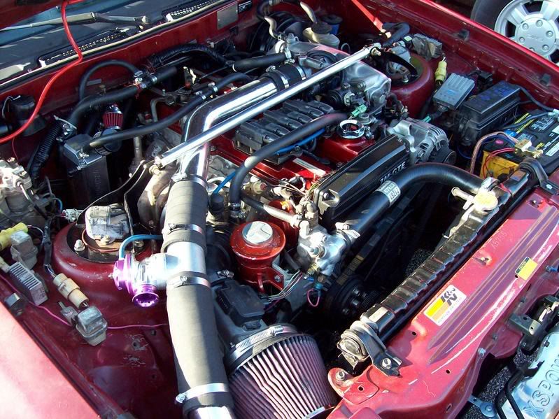

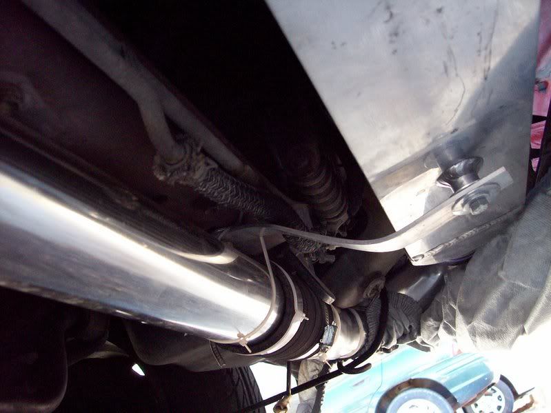

7MsuprO
Apr 29, 2006
322
Huntington Beach CA/Ohio
...hopefully that helps you. It doesnt matter what side hooks up to what piping but it generally makes more sense to hook it up this way. Look around for pictures and that'll be plenty of help. The AFM has nothing to do with intercooler piping.
