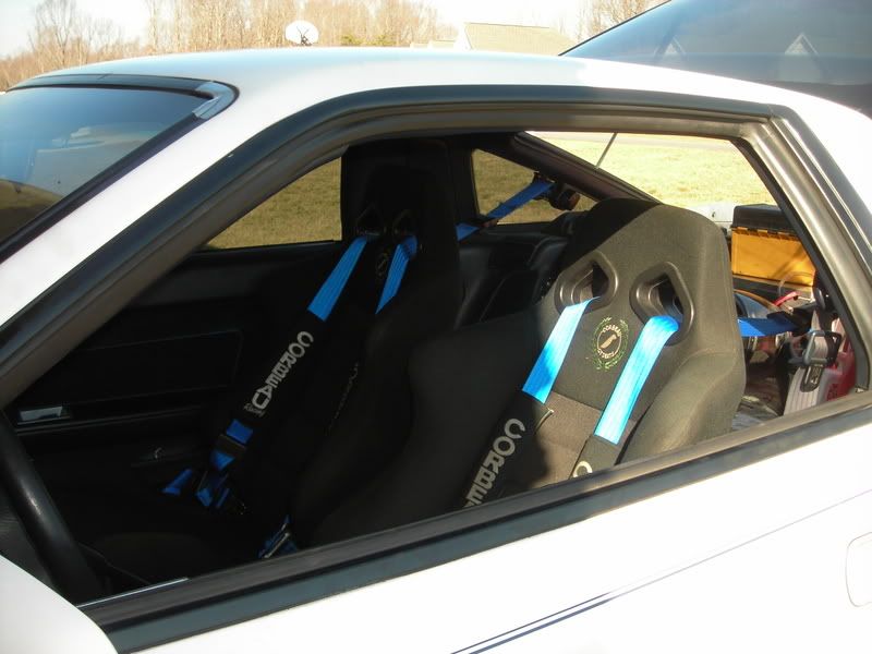

corbeau makes all kinda seats and they have direct fir brackets... i used them for my integra and when i change my seats out again i will be using them again

i have the corbeau in mine as well. buddy made brackets for mine since i wanted to fit the seat lower. stock seats my head is on the roof and was esp difficult to wear a helmet. the brackets he made sit the seat almost on the floor.
whatever route you go, don't skimp on the seat and really do not skimp on the brackets. buying the ones from corbeau is your best bet really.

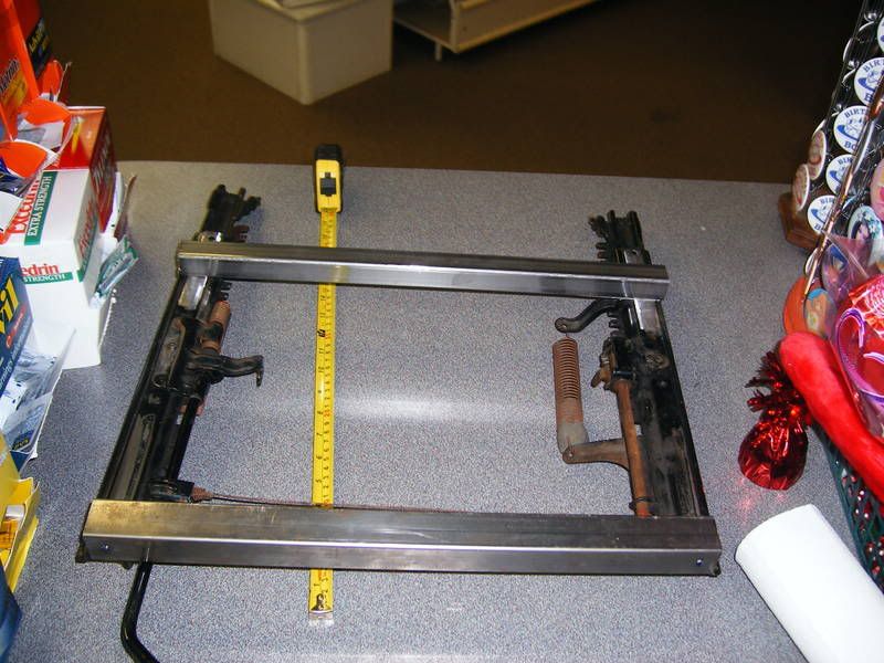

what i did was, take my passenger side brackets (because their manual) and cut them off of the top part of the seat.
got a square tube bolted and welded on to the rails, and the kirky seat i have bolts to the tube!
i still have seat adjustment!
ill finish it up tomorrow so u can see ho i did it if youd like to go this route!

Yes I'm leaning towards making my own bracket like you did Madsupra88.
That way i could pick how high i wanted the seat.
