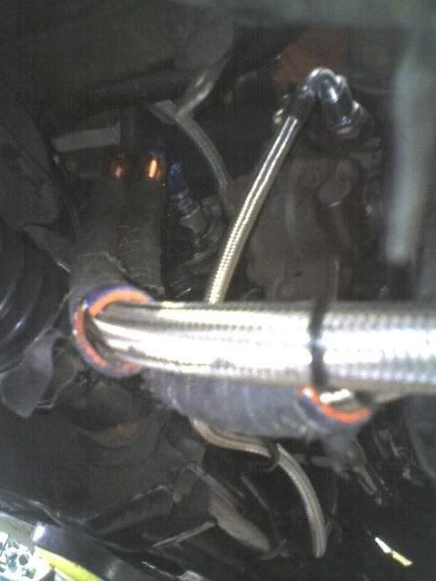

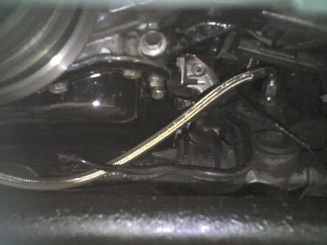

Here's how I ran mine
Pump
To rack
Pretty easy stuff. However it was quite a pain to get the original hardline out. I eventually ended up taking a hacksaw to it and cutting it in half.

Routing is just as pictured above. Straight down from the pump, across under/just in front of the oil pan, and up to the rack. I do have my own pics if anyone wants me to post them, but it's an easy install.

If a lift is very easy access then yes, otherwise in the driveway on stands should be no more than an hour. I took 3 hours and that was with a couple 15 minute smoke breaks, stopping to clean the reservoir (it was black), and snapping pics.
The pic with the arrow is the 'bolt' that needs a new o-ring (2 actually, an inner and an outer). The PO had tightened the PS hose so tight, the arrowed one was stuck to it.
