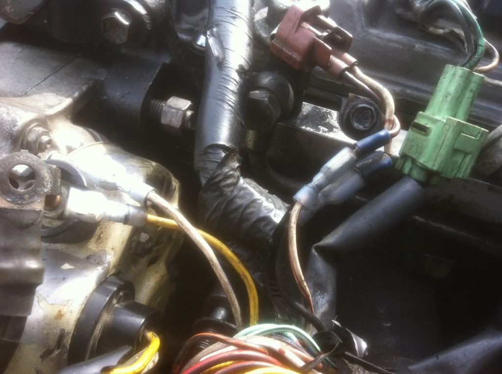

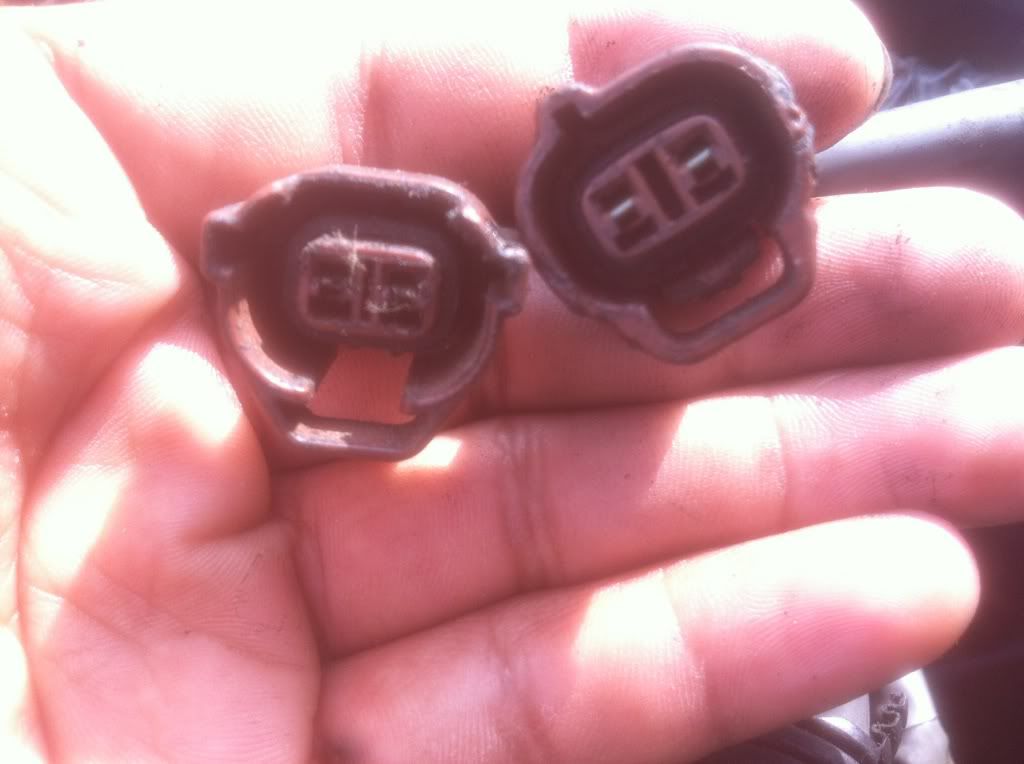

So i bought this crappy harness and im already at the point of putting everything back(because swap) and once i try to plug in the injectors guess what?! they dont clip on ! Heres a picture
im on mobile lol the left one clips on and the right one doesnt whats weird is that is has two types of clips the harness i guess he was running different injectors? Anyways the clips from my na harness clips on the 440s turbo injectors but those are for the yellows i was wondering if i can cut those from my na harness and put them in my turbo harness ? Would i just put them by color or switch around the wires or what ?just wanna make sure also what color wires are for the injectors here there black and white with red wires for the brown clip and the white clip are white and yellow ?

You can use the na clips. Don't need to cut them. Just depin the connector and swap the connector over.
But first you should make sure you have the right connector. Should be 3 brown and 3 gray alternating. Looks like you have 1 injector clip and 1 vsv connector in that pic.

Ok and it goes brown grey brown grey and so on with brown first? So the yellow and white are for vsv not injectors ? what colors are the wires for the grey injectors like the brown clip is black and white and the grey clip what colors are they because all the wires are free and didnt have any grey clips attached to use those as reference.

Yea i got mixed up with the vsvs actually i had to cut them bc turns out there was no injector clips and the wires were really short so i had to thanks !
