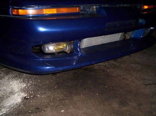

couple more things: The battery shows 12.5 volts with a multimeter. The voltmeter inside showed like 3+ before but then droped down to zero. Now it just shows zero and even the lights on the doors dim or go out when i turn the key. I cant even get it to run the codes cause the light is so dim.
THe starter relay was buzzing when i first tried this morning so i replaced it and it changed nothing. Still buzzed right after. I reset the cirtuit breakers with a pin like you were talking about but heard no click and it didnt help.
Oh and the tach would go up to like 2000 when i tried starting.
Thanks alot for the help guys, I realy appreciate it.

Cool, that's good news for you and the bonus was that your heater blower gremlins have gone north for the summer. Now what about your fog lights? Oh, and your welcome.
