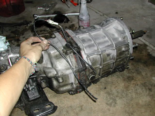

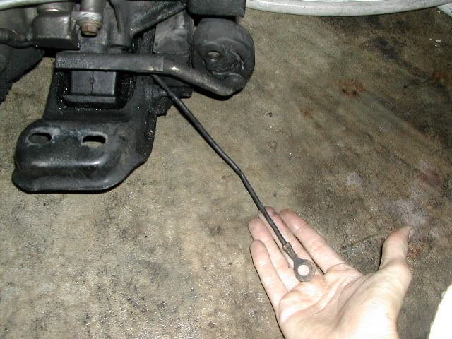

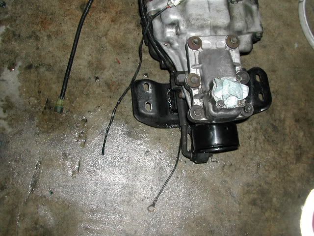

I got to taking off the bell housing to replace it with the 1J one that i'm yet to find....and I noticed these wires that I don't believe were hooked up when I pulled the old 7M. Can anyone id these for me? Please and thanks

The one in the second pic is the reverse switch, for reverse lights.
The one in the third pic is a ground.
There should also be a ABS speed sensor. I think i see it in the first pic but its hard to tell.
