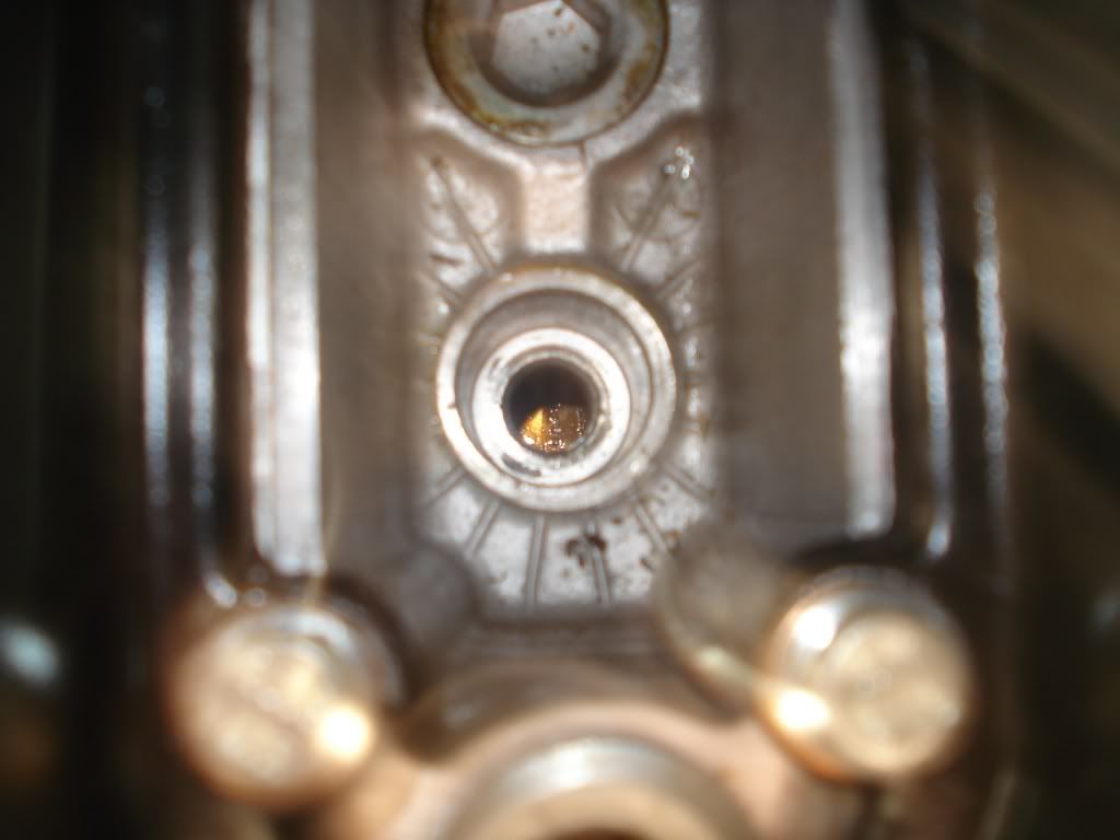

I stuck a q-tip into my CC, and i wiped the top of the piston off, and it came up dirty, but it didnt wipe away the goldish brown layer on top of the piston... so im wondering if its normal for a fresh set of pistons to start to turn a tanish brownish color? i took some pics so you could see what color (there not the best but they'll do)
Edit: i just watched the video, and theres only smoke on one rev up?.... wtf? i'll post it anyways.
HOT compression test came back with a 150psi... but that was only on number one. so yeah...
#1 Top of piston... its a goldish tan/bronze color (its almost like its a clear coat of that stuff, cause it doesnt wipe away...?)

Yes, pistons usually are gold in color after use. Your plug well is dry, good.

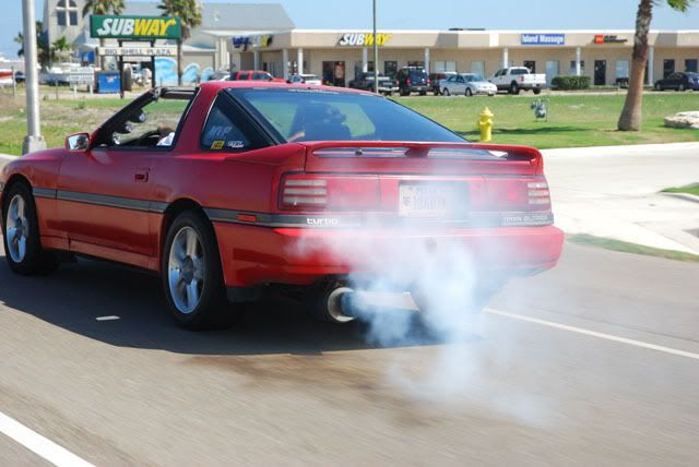

This is my car on decel
Bad valve seal (probably more than one) and the car runs hard as hell. Makes plenty of power and has run deep in the 12s. Just because its making power doesnt mean it doesnt have bad valve seals. Yours looks to be very, very slight, if any leakage. My car POURS out smoke. The car is full of smoke when I come to a stop.
