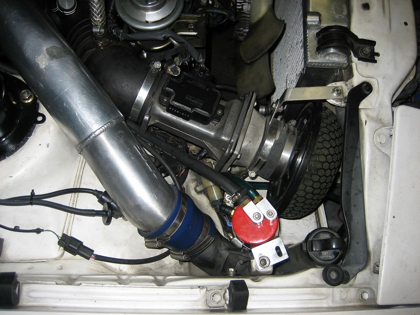

How to tell if my maf is lexus?
paulmicin
Apr 7, 2008
Norwalk, Ca
heres a pic for reference.
Mikek3
Sep 2, 2008
86
South Florida
Looks stock to me the lexus afm(not maf) is a bit rounder on the bottom but its hard to tell from the pic, when i get around to it i have a stock one in a box i well tell you the part number

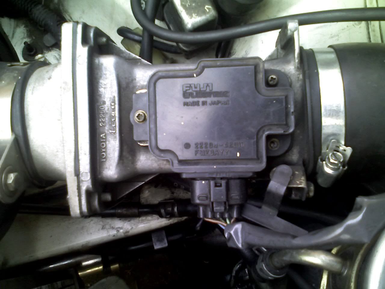

Electronics don't make a difference. I'm running the lex electrics and the stock housing. Chris J has been running the Lex housing and the stock electrics.
Found it... Open things up and look at the inside.
