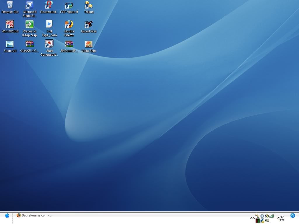

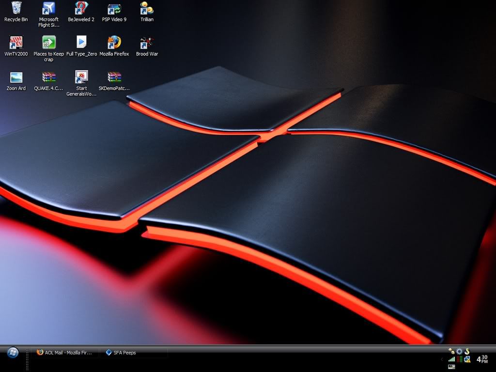

here are the 2 i am currently running... this is on windows xp pro
vista skin
and Mac OSX Skin
