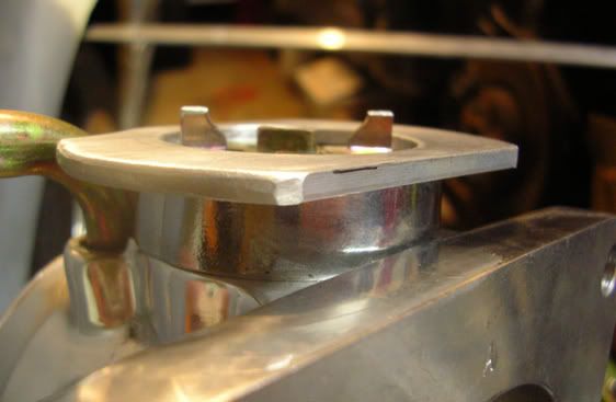

several people have asked how this is done. after talking to some people i had found out the ford tps uses the same voltages as our stock tps. this opens up a whole new world of bigger, inexpensive and readily available throttle bodies for our car. this would mostly apply to those who are going with a front face intake, but you could use on the stock intake if you made an adapter.
there is one small catch. you have to use a switch for the closed throttle position on the idle validation circuit. you could pick up this switch at radio shack or you could use a nitrous throttle switch. from there, you make a bracket to mount the switch so the throttle bracket will close the switch under idle.
my bracket was made off of the unused flange for the egr.
here is a diagram for the wiring.
notes:
if you are using a stand alone management system, you do not need the IDL switch. this is only for use w/ the stock ecu.
the throttle body i used was a 86 ford mustang 75mm throttle body upgrade with a new tps. can be found from blue oval industires for $120 for the polished version.
jimi87-t also has a write up to install the stock tps to the ford throttle body if you would rather go that route

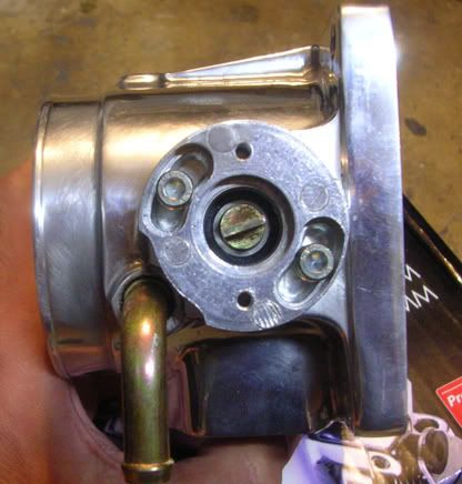

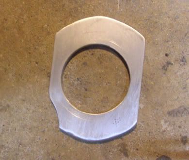

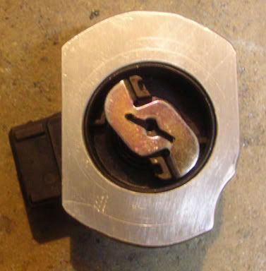

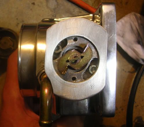

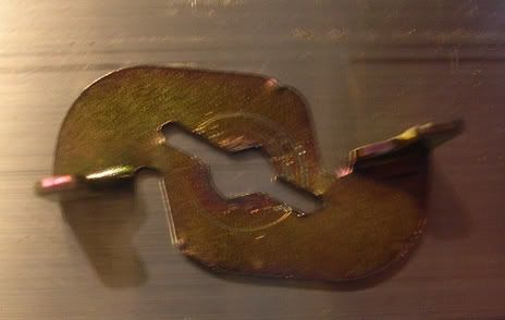

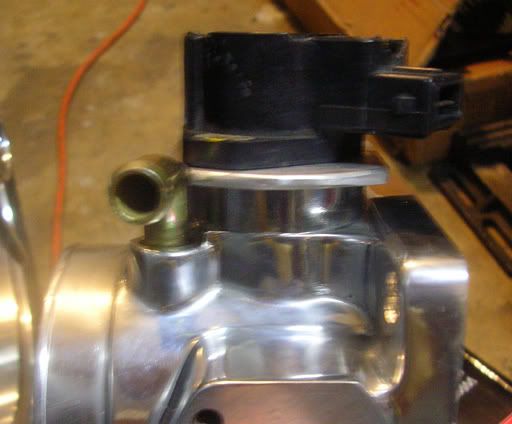

To add to the info here, this is what I did to make the toyo TPS work with the same type TB. Pics say a 1000 words:

Great info, Not to hijack, but to add to the info here, this is what I did to make the toyo TPS work with the same type TB. Pics say a 1000 words:
