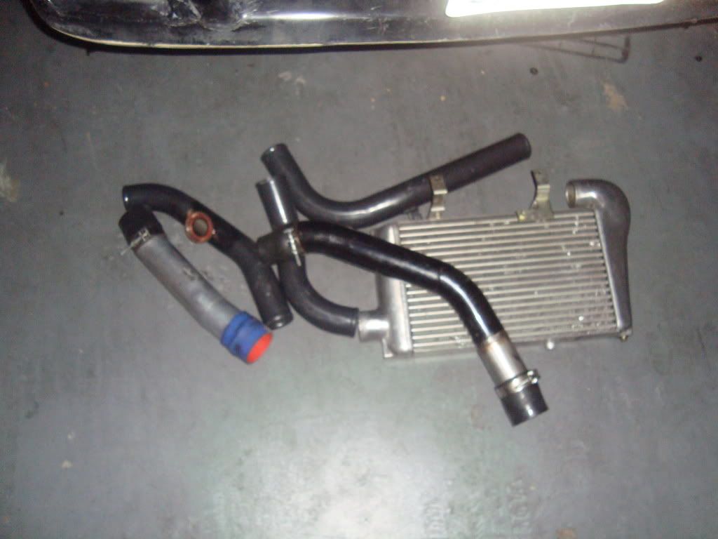

Here's the piping that came with my kit:
I got brackets with mine???
I can get install pics and possibly the instructions tomorrow.
