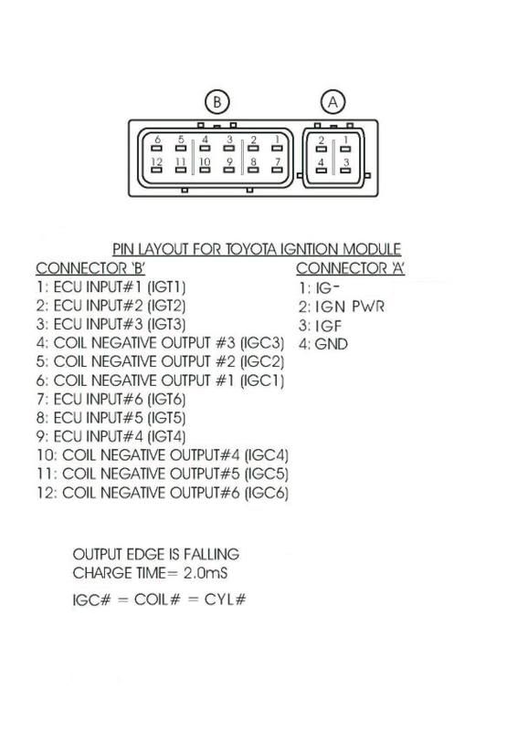

I've put an image showing the igniter pinout below. It is shown looking AT the igniter, not the igniter plugs so you will need to take this into account! If you put the 'test light' with the positive leg on the IGT1, 2, 3, 4, 5, 6 pins of the unplugged igniter plug and the other leg of the 'test light' to battery negative (ground) then crank the engine the 'test light' should flash.
If the 'test light' doesn't flash then trace the wiring back from the igniter plug to the AEM. If all the IGTx seem OK then you'll need to test your igniter on another engine, or find a known good one to test on yours...
