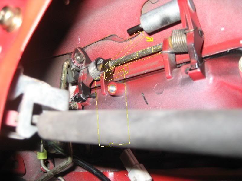

Can anyone tell me where or how this piece does onto the door handle?

Hey man- I just did that piece yesterday. The switch in the top pic bolts onto the inner handle, so that it sits vertically. You see that little U-shaped cutout on the bottom of the mounting tab? There's a small post on the lower part of the inner door handle, that that cutout will align with. The microswitch lever will sit under that shiney cyinder at the top of the door handle. Get it?
