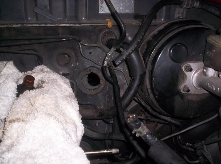

Today we got it drilled and ready to go. W/ the engine in the car we couldn't get to the speedo hole w/ the drill so we drilled down to the right (looking at the firewall) of it. Should be good as its about where the harness will run across the intake manifold.
Josh (thereaper) got some pics, will probably be up later tonight or tomorrow.

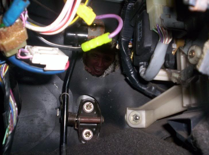

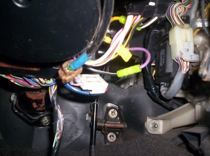

The Reaper
Single, and lovin' it!!
Jan 10, 2006
1,909
Florida
ok here's the pics
with the grommet(sp?)
here's from the inside
