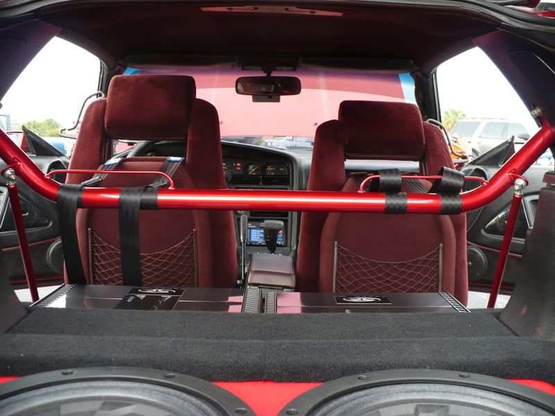

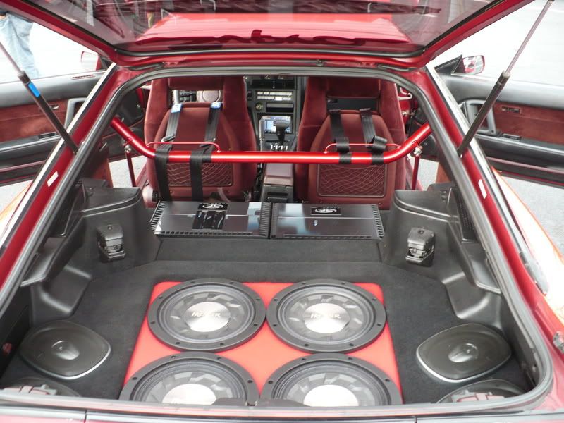

Im reading a lot of mindless dribble here in this thread, and most of it could get some one killed.
Your harness bar needs to be welded or bolted into a MINIMUM OF 4 MAIN CHASSIS POINTS.
Four great points would be the rear bottom and front side seat belt bolting / anchor points.
This harness bar's main bar needs to be a minimum of .095" 4130 or .120" DOM, 1 3x4".
The plates need to be no thinner than 1/4", mild steel.
The runners that connect the main bar to the lower rear seat belt points need to be a minimum of 1 1/4" x .095" 4130 or .120" DOM.
As for your belts, 4 points are better than stock, WHEN CORRECTLY FASTENED AND TIGHTENED.
Most people want to look "cool" and flop around in their 4 point harnesses like a stock 3 point will let you.
When you wreck head on, you "submarine" under the belts and your knees become the next coolest dash ornament.

Thanks for the good info.Probably 70% of the harnesses I have seen in street cars were installed incorrectly,scary shit.I have had a 4-point harness save my life on one occasion(flipped my sand rail/go kart at over 70 mph,twisted the frame all to hell,but I walked away unharmed.Had just re-installed the harness the correct way the week prior too.That is one of the reasons I started this thread,I was curious as to if the back seats were accessible with the harnesses correctly mounted.
