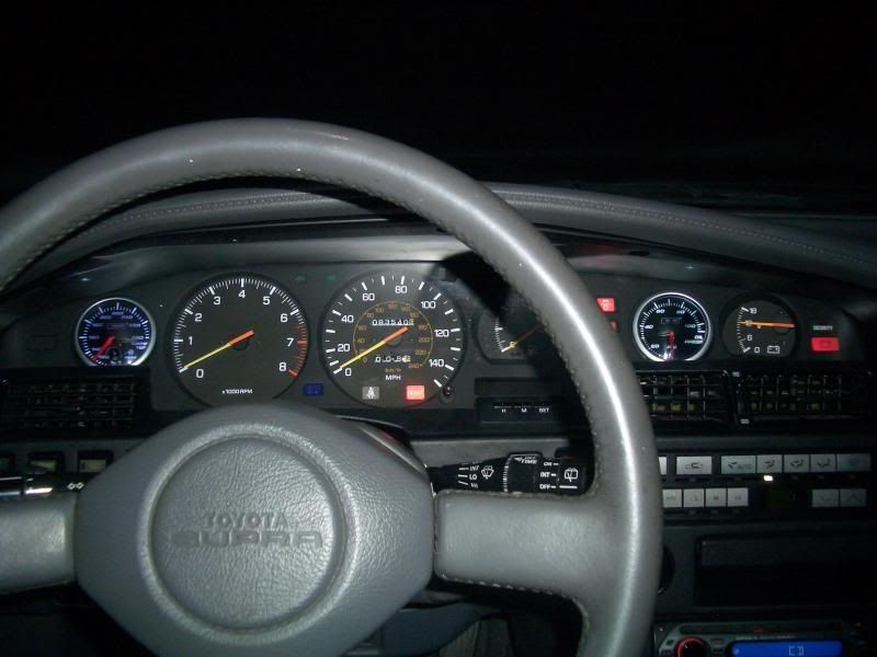

mattsplat72;1114244 said:
I took two cups and mounted gagues in their respective places in front of the ones they where replacing and I mounted my boost gague where the lighter was cause I dont smoke
I mounted my A/F gauge in the lighter socket, popped the lighter out, then used a Dremel with a cut off wheel to open up the socket to fit the gauge. Looks almost stock IMO, plus you have a convenient ignition switched +12v line (the one the lighter no longer uses) right there for the gauge.
