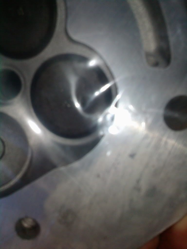

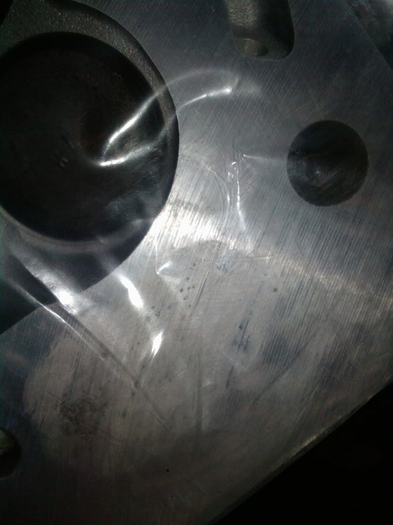

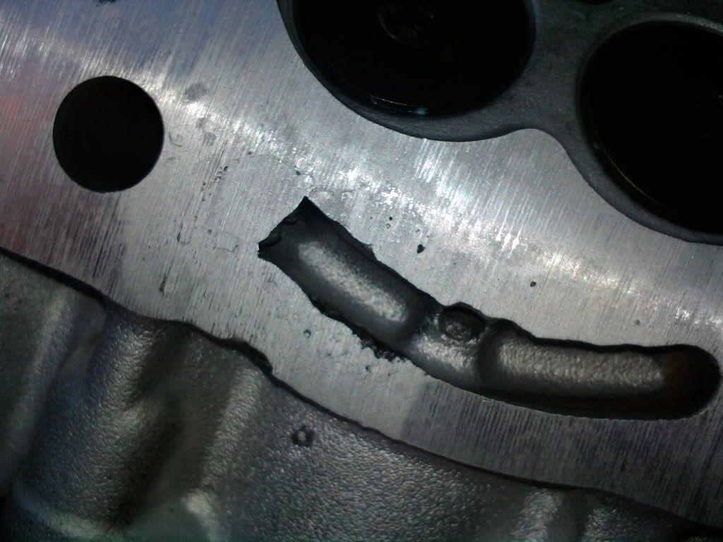

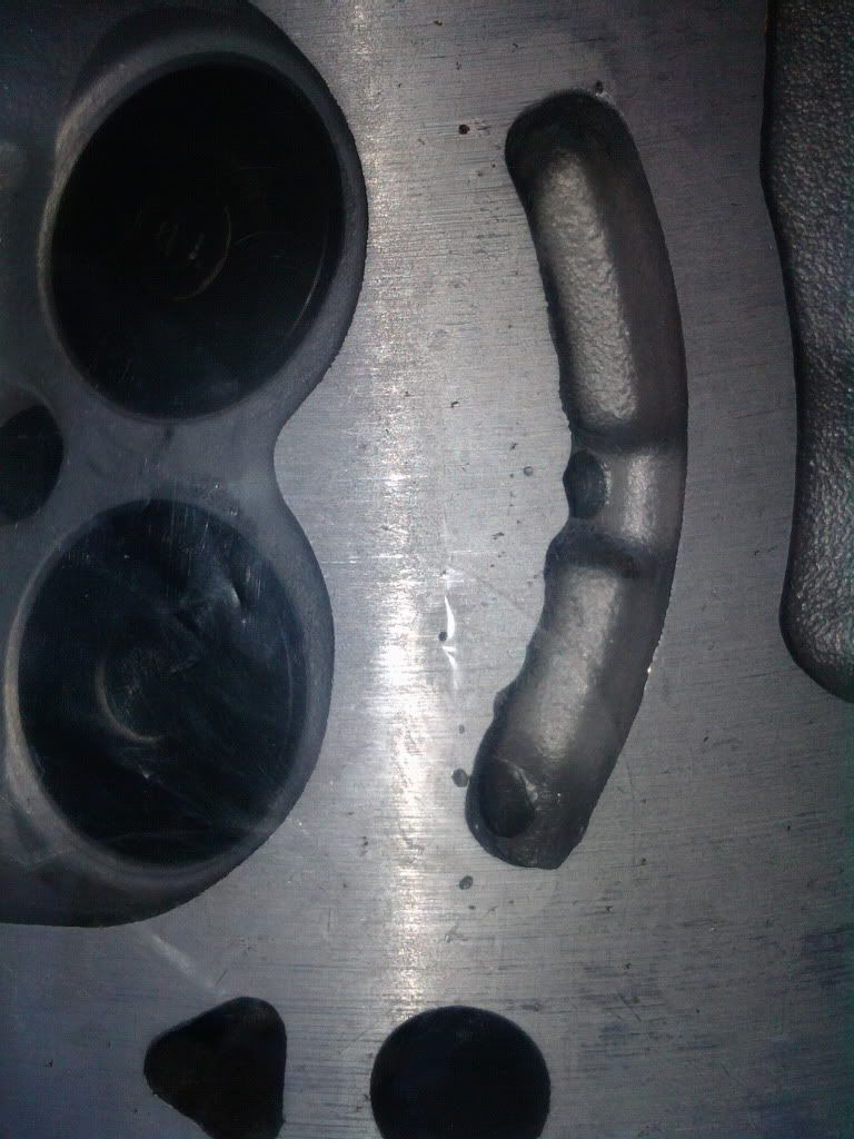

So here's some pictures.
It has some tiny little holes and it is scruffed up in some places..
Im using a Felpro gasket and APR Studs got em from driftmotion
Got it Cleaned/surfaced/welded and resurfaced it had 4 bent valves 3intake 1exhaust all redone.

Yeah, boy,.. I don't know, I don't think I'd run it, They may have taken a lot off. Why don't you pour water in the water jacket and then look at the holes to see if it leaks water.

^ buy you a new damn head! i forsee those holes leaking, then getting bigger. did you give them a max tolerance for how much to take off? if not good luck getting a new one, they will just say "you didnt tell us when to stop" yet anyone should know "hmmm those holes werent there when i started"...

Sucks to see this. Pouring water will not help, the cooling system needs to be pressurized to see any pin hole leaks.
Measure the head and see what the height is and post here. You measure from the deck to the top, were the valve cover gaskets would rest.
