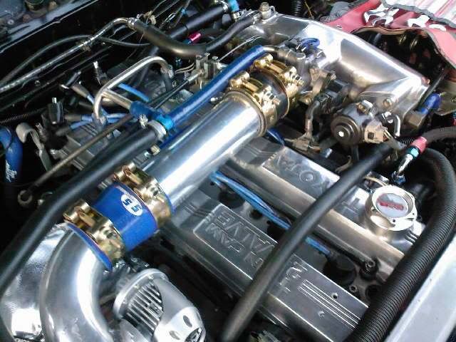

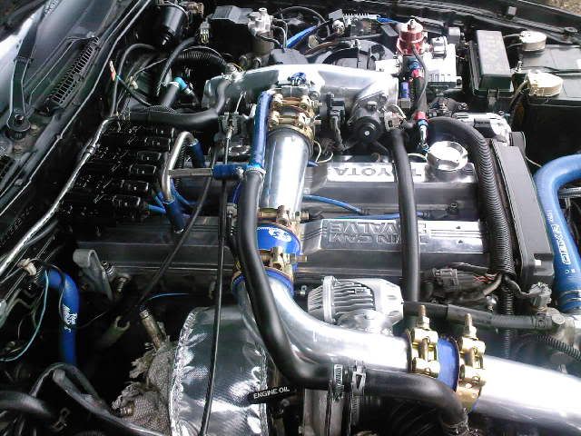

well another step forward, i've read a few things about the fpd but decided to ditch it anyway, was more shock at how many banjo fittings there were to get to the fuel line, thankfully they are all gone now, so should have a bit better fuel flow, got my polished fuel rail on to and the n/a covers on, wow much better and now the crossover pipe fits way better, new ssqv version 3 is also now on :) got a few more things to do tomorrow and get the coil packs back on, i managed to use an old hose for the pcv luckily, but as this is my DD i couldn;t go anywhere to get more lines, for information tho a 8mm joiner fits perfectly in the soft line fuel inlet. only got the one pic but will do a few more when i get back to it in the morning.

looks good man. sorry for the newbness but are you running stock coils? is there any real trick to mounting them at the back of the head? just swap the wires around and then extend the harness or will it reach back there?
i really like the cleaner look with them back there, seen it on a few rides but never bothered to ask anyone

its ok if you ask you get to know lol yeah just extend the harness and swap the leads round a bit, luckily there is just amount of metal at the back to mount it just line up the coil pack so your happy with the position and drill the lip :)
