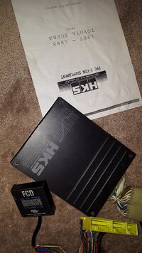

After doing the 12V mod, all of the hks electronics goodies and gauges were installed and in doing this, I tried to make sure I had it looking as clean in the engine bay and interior as possible. 20220312_173642.jpg20220312_172756.jpg
I wish there was still a mount for the pfc f-con so it's just chilling in the glove box with the FCD...

Hello. I also have a hks VPC, but a chip for 1G engine.I bought a 7m rom on ebay but it didn't work. And then I bought a 7m rom from Gordon in Texas. Unfortunately it didn't work either. Do you have a rom chip in hks vpc for 7mgte?
Does it work properly for you?

In my fcon and vpc I have the roms for the 7mgte with the 550s and for the fcon to work with the vpc, think it's E105V and SUP009B if I recall. If you're on a 1G then the roms might be a bit different. There use to be a website called 1JZMERC that had the info on the different roms, but that site has been down for a while now sadly. It had all the instructions for these too. Gordon should know the roms for a 1G though, he's where I got the one for the VPC and I also got the E164 rom too from him
