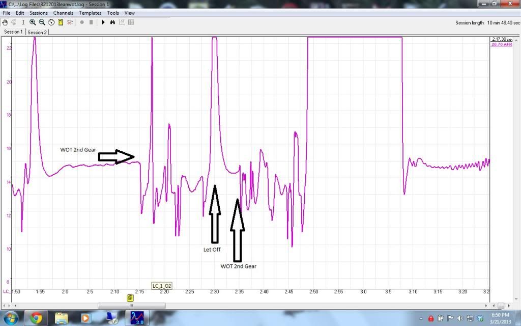

For the past two weeks I have been noticing under wide open throttle my air/fuel ratio goes scary lean. The only code that shows is 34, which from my understanding, is from fuel cut. I am running the stock ct26 hooked up to stock wastegate not shimmed (roughly 12PSI). That alone seems weird to me... maybe my intercooler is really efficient?
MODS:
Cxracing Intercooler 2.5" pipes with a recirculated freddy BOV
Innovate LC-1 wideband
3 Inch no cat exhaust
Stock ECU with knock sensor rewire with sheilded cabling
Stock Fuel System
Stock AFM with aftermarket cone filter
New Denso o2 sensor as of last year
What I've done:
Re-set timing
Calibrated TPS
Here is a sceenshot:
Here is the log file from logworks
Any input would be great as I am stumped where to start with this problem.
Thanks in advance!
