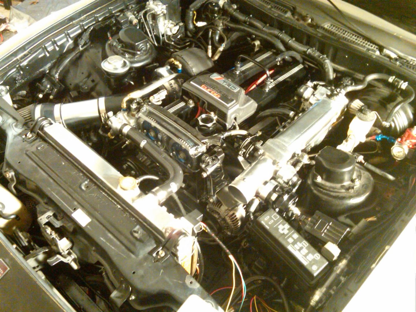

Heres what I did I used a 1G DSM BOV and crushed the top great cheap BOV but leaks at idle like most factory BOVs the pic shows how I routed the recirc and I mounted the BOV under the intercooler piping car ran 12.5@ 110 mph and was a daily driver until I sold her cheap but effective solution
