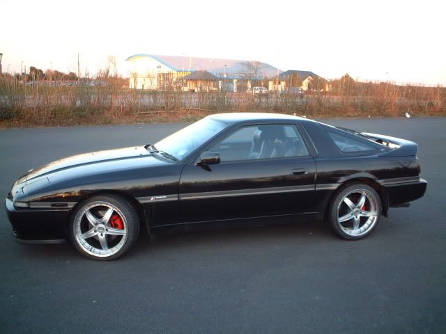

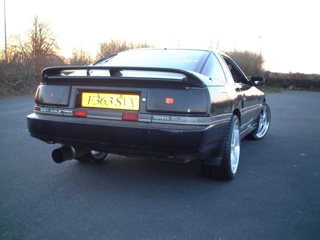

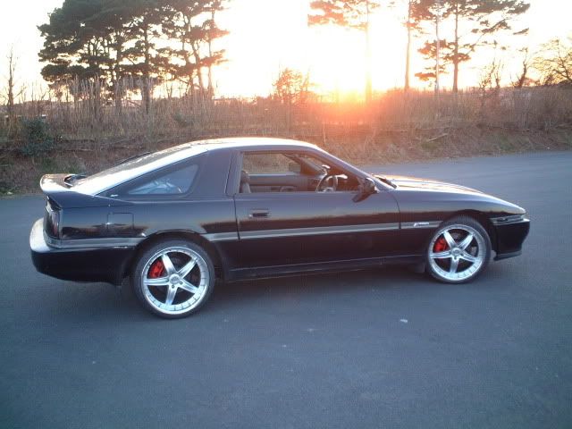

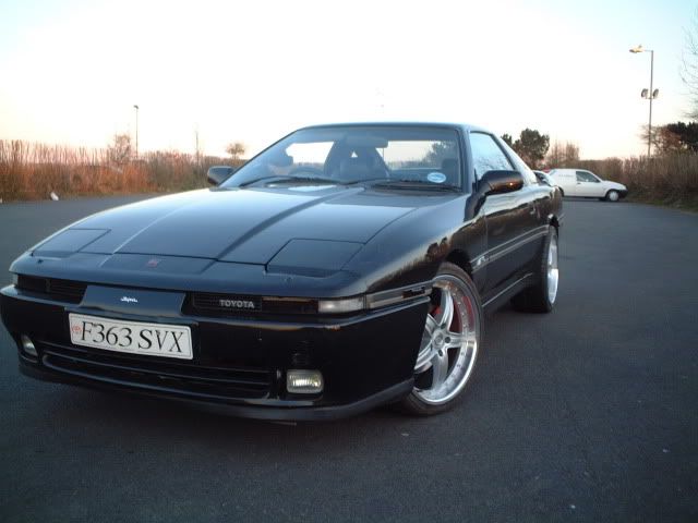

OK so i just got new rims the other day. I am running 19"/8.5 up front and 19"/10 in the rear. Tyres are 235/35/19 and 265/30/19. Offset are 35 front and 38 rear. No rubbing on this set up but i will say that if i had a wider tyre on this set up it would hit the rear arch as the rim sticks out past the body.
Here are some pics.
Hope this helps.

that's awesome! same exact setup i wanted.... i found some nice 19x10 and 19x8.5 as well. what tires are you running? last time i checked, there are only 2-3 brands if i remember correctly that offer those tire sizes.
