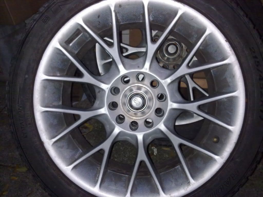

i just got a set of used enkei rims that i'm gona put on my 88 supra na. here's what's printed on the rims: JIL VIA690KG 17x7J, MAX1580LBS ET40, E1110 MADE IN JAPAN
i already know the bore size of my supra (it's 60.1mm) but i don't know the bore size of these rims. i tried to google it but couldn't find any info. enkei's current website doesn't have this model (maybe this model is too old). i tried to measured it myself with a ruler. the best i could come up with was around 73mm (but the ruler might not be that accurate).
there are two different centric ring sets around this size: 72.6mm and 73/73.1mm. so which one should i get? i took a pic of one rim. anyone recognize these rims and know its exact bore size?

You could always try calling Enkei if you can't get your hands on a caliper to measure it properly, they might be able to help you. :)
Edit: That "E1110" part makes me wonder if it isn't a 5x110 pattern wheel. In which case, it wouldn't fit your car anyway. Have you tried test fitting them yet to make sure they work?

thx for the heads up. i just called enkei and emailed one of their sales chris, a really nice guy. he emailed me back almost instantly with the bore size i need. it's actually 72.6mm. i did try one of the rim on my supra. it fit in perfectly.

Good to hear man, now get some 20-25mm spacers to make those wheels sit in the right place. ;)
