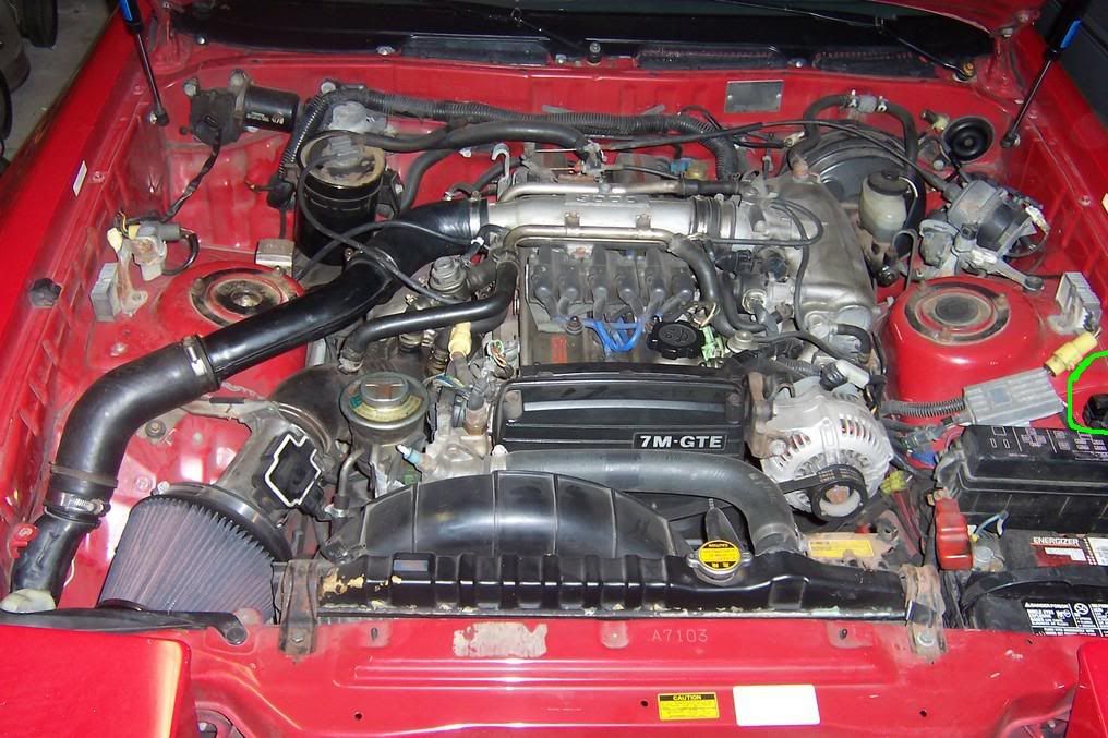

to check for codes...there is a diagnostic box on the right side of your engine bay. It says diagnostic right on there i believe. All you have to do is make sure you car is off...stick a paper clip in there to connect them...then go in the car...make sure your a/c is off...and then start the car. The check engine light will then blink in a series of short and long beeps....count the number of each and that will show you what code you are throwing.

its on the drivers side of the engine bay close to the brake master cylinder. Its about 3/4" wide by 2" long. The color is black or grey. It says diagnosis on top, and if you open the cover there are several pins. You will want to bring the TE and E1 pins of the connector. One should be in the middle of a group of pins, and the other should be diagonal from it, in one of the corners of that group of pins. I believe they are in the section that has 9 pins. The underside of the cover has a label on it that states the names of the pins.

sorry for not having the diagnostic box directly in the pic, but its the best i have. The box is circled in green on the right side of the pic

supraman2251 said:
I was hoping that wouldnt be it, see pics:it came without the cover
it should still work
*edit* im sure if you look in the for sale section here anyone that is parting out their car will have one. Not too many people ask for that cover
