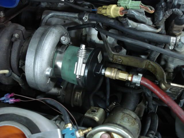

I tested with a boost leak tester today and found 1 vac leak and noticed the EGR makes a gurgling noise. But unfortunately it still has the same problem. Things I'm going to do this week are put it new plugs (copper this time) and re-check ignition timing just because. It would be nice to figure this problem out so I can bolt on the 57trim.
