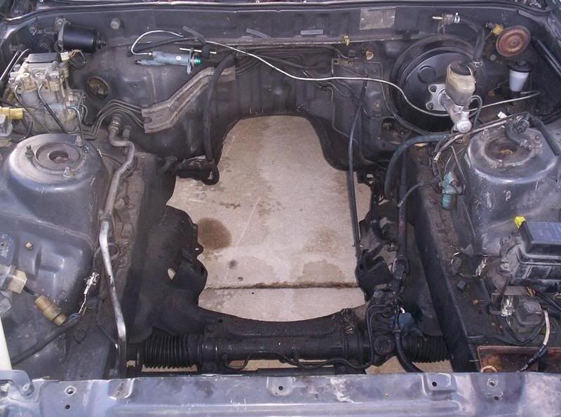

yea its definitely fine....i went hog wild with mine.
here's before

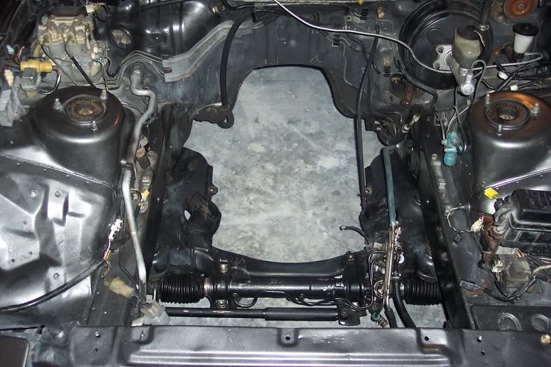

and here's after purple power, and some gunmetal wheel paint for touching up scratches.
definitely worth it!!!
*grumble*
don't use castrol super clean or purple power on anything painted or aluminum...
it WILL strip paint, and I've use it such! it likes to eat aluminum as well...
Use simple green if you're being cheap (though it tends to suck the oils out of rubber parts and makes them look dull), but I highly recommend a dedicated engine degreaser as it will cut the grime the best, not eat the paint, not destroy plastic or rubber, and the good ones will even leave things shiney afterwards...
