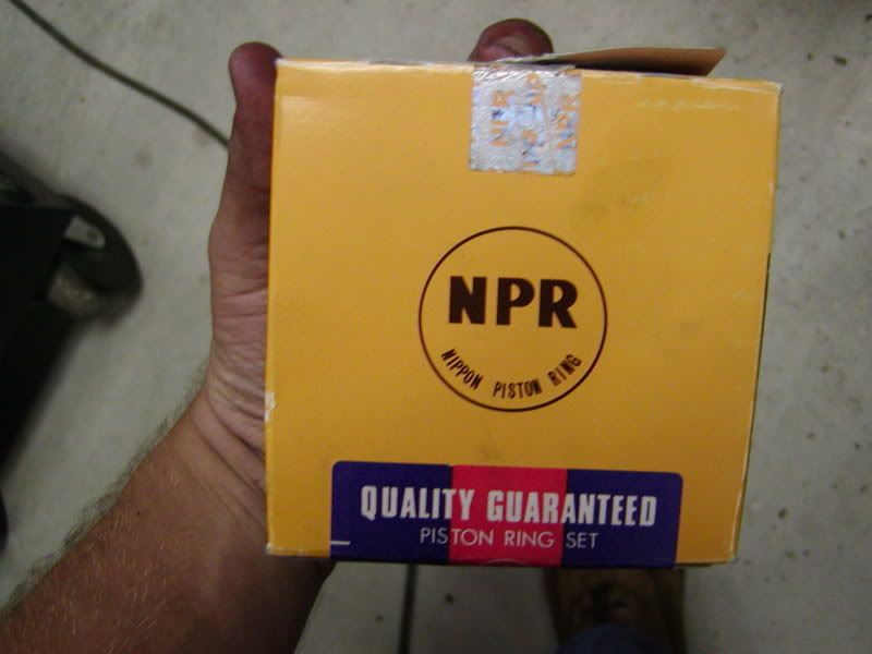

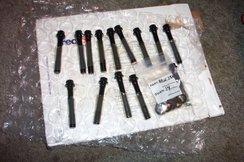

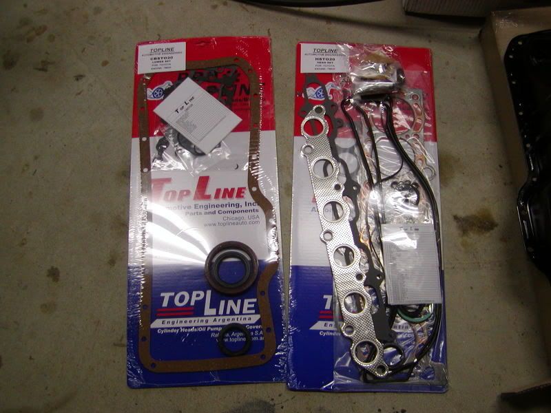

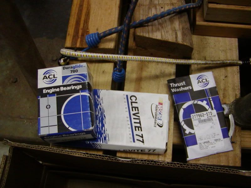

I used NPR piston rings and acl main bearings and they've worked GREAT.
This is what i used for my rebuild.
ARP
The TOP LINE gasket kit. EXCELLENT!
Get pistons and rods from dealer or HorsePowerFreaks.

That's some good stuff. I used almost all of the same stuff when I rebuilt the 22re on my 4runner. No complaints so far.

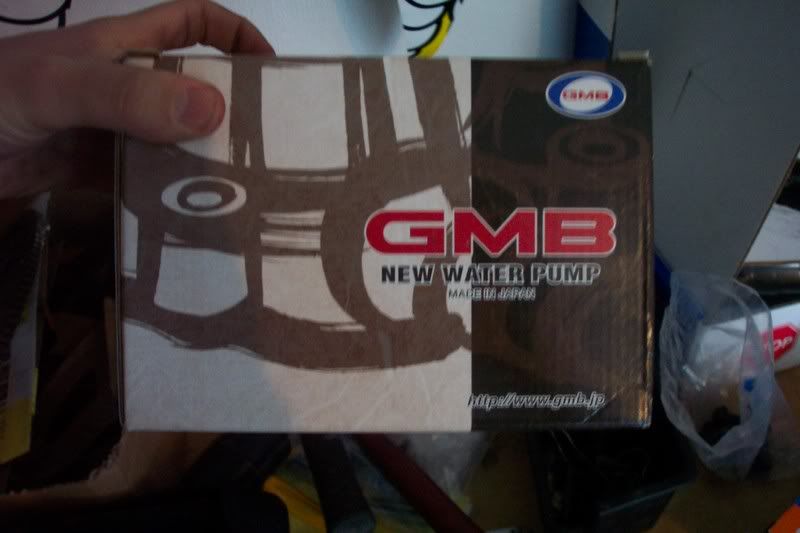

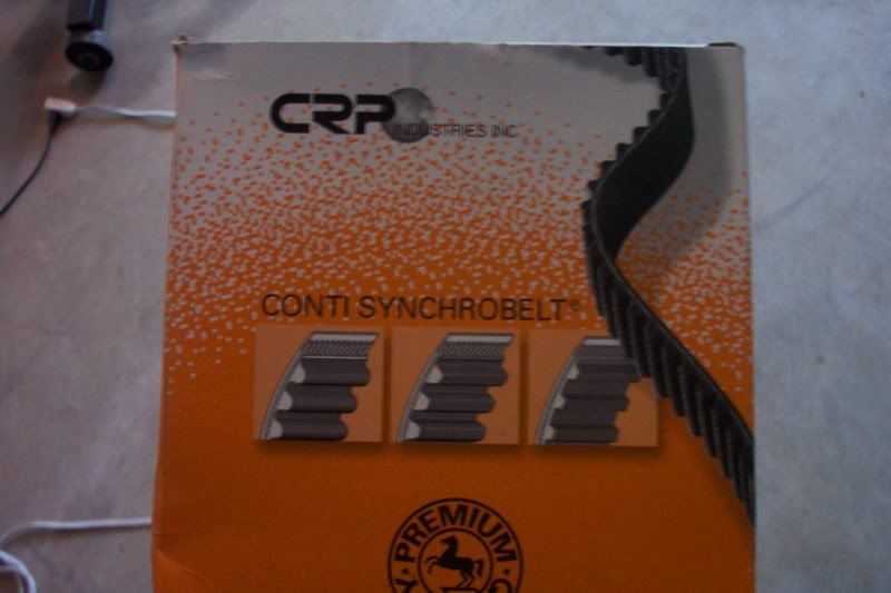

if you can't get a hold of the "top line" i can get them through the shop i go to.
Nippon(30$)
Arp(100$)
crp(30$)
TopLine(200$)
GMB(30$)
Something of the lines of those prices. Not to bad. Don't Have exact prices and may have changed.

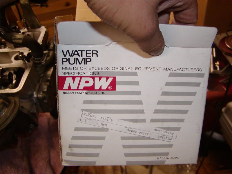

But whatever you do, don't get this pump. It's a pump, made by Nissan. How that works i dunno but i had gotten it and it just sucked a fat one. Made for our cars but from a Nissan company(i guess kinda like a common last name or something. Smith, brown etc. i guess)
Here is the acl and clevites i used
