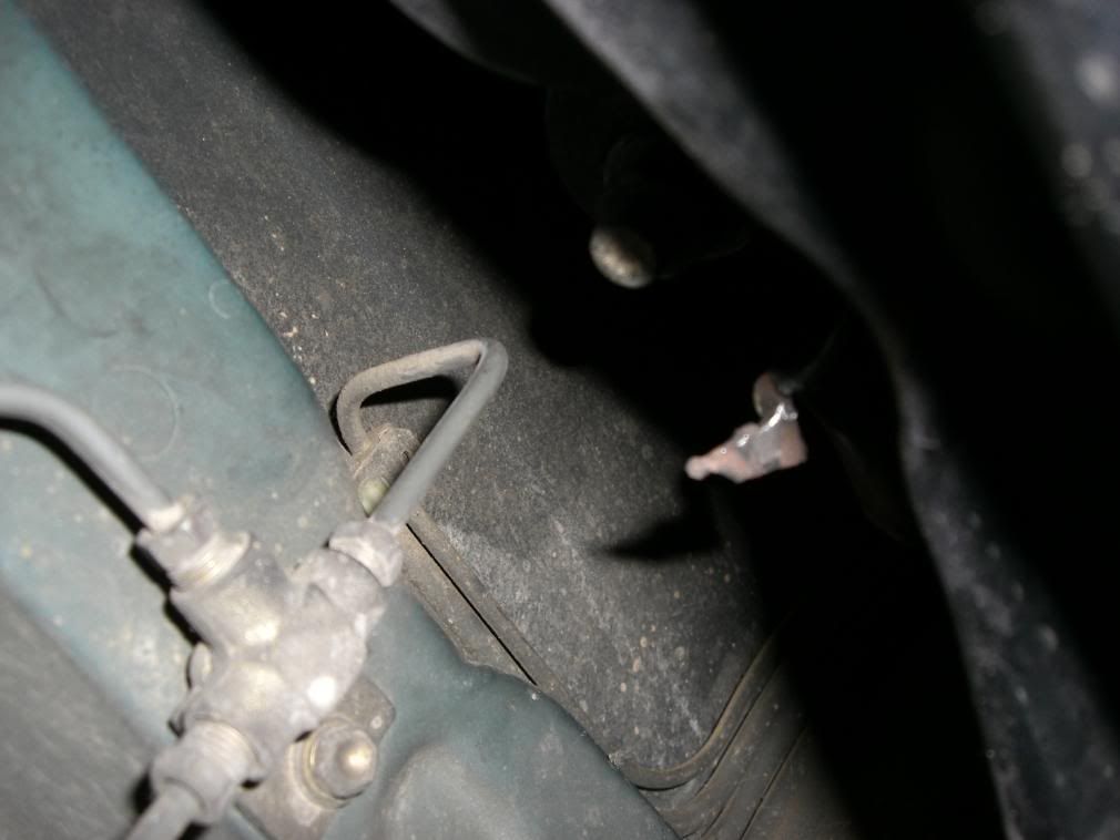

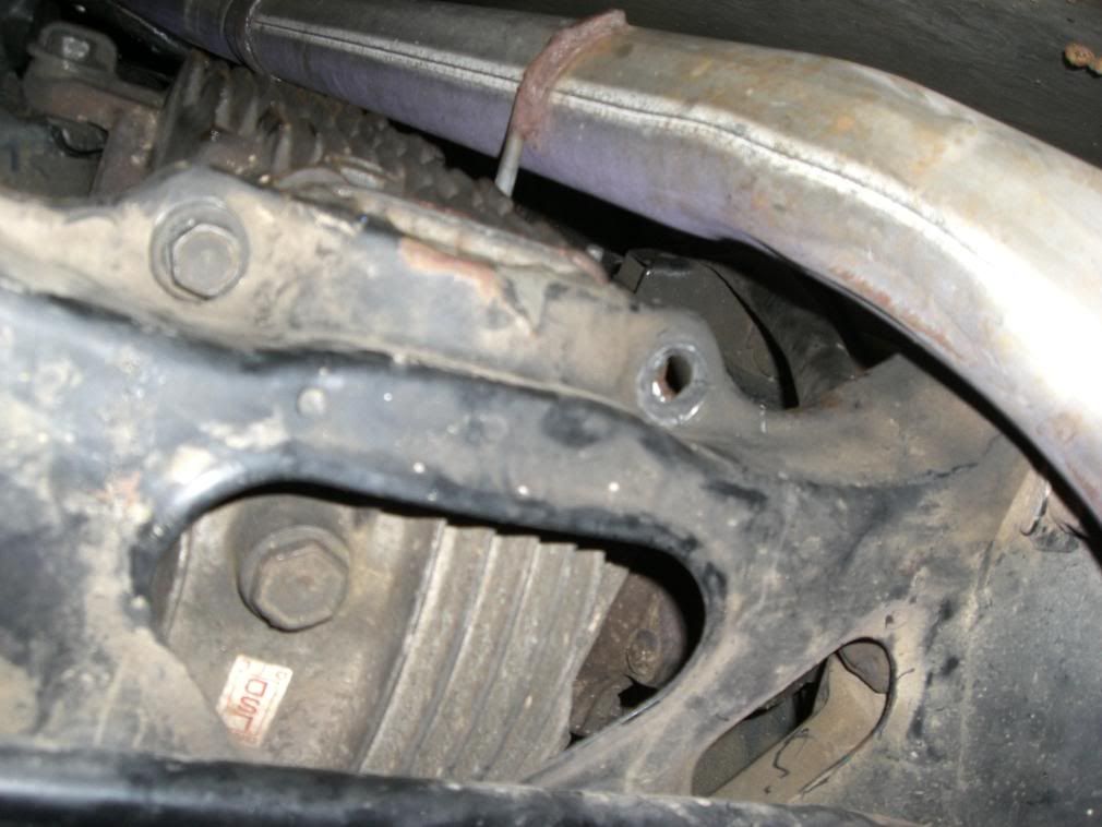

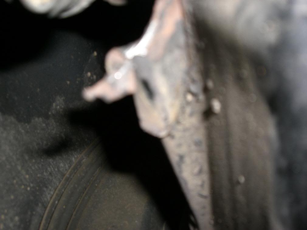

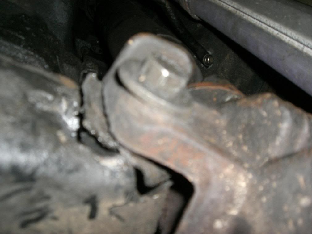

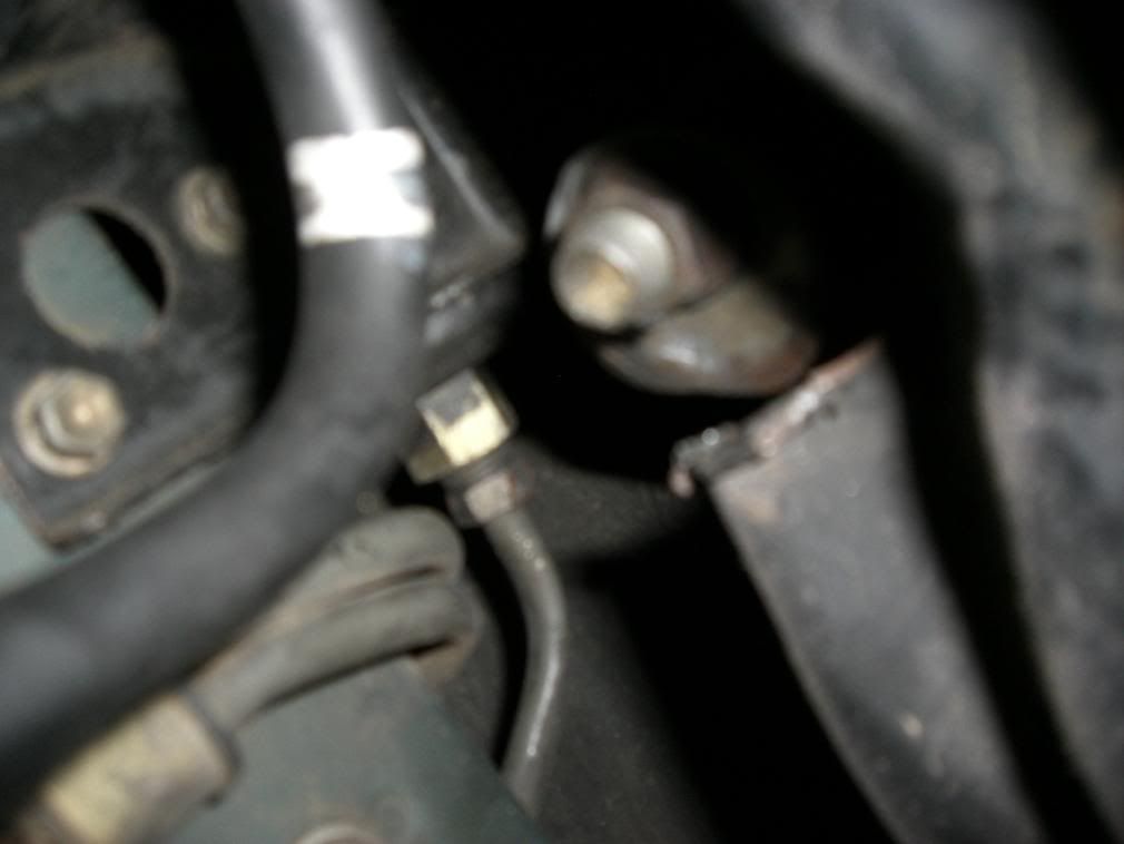

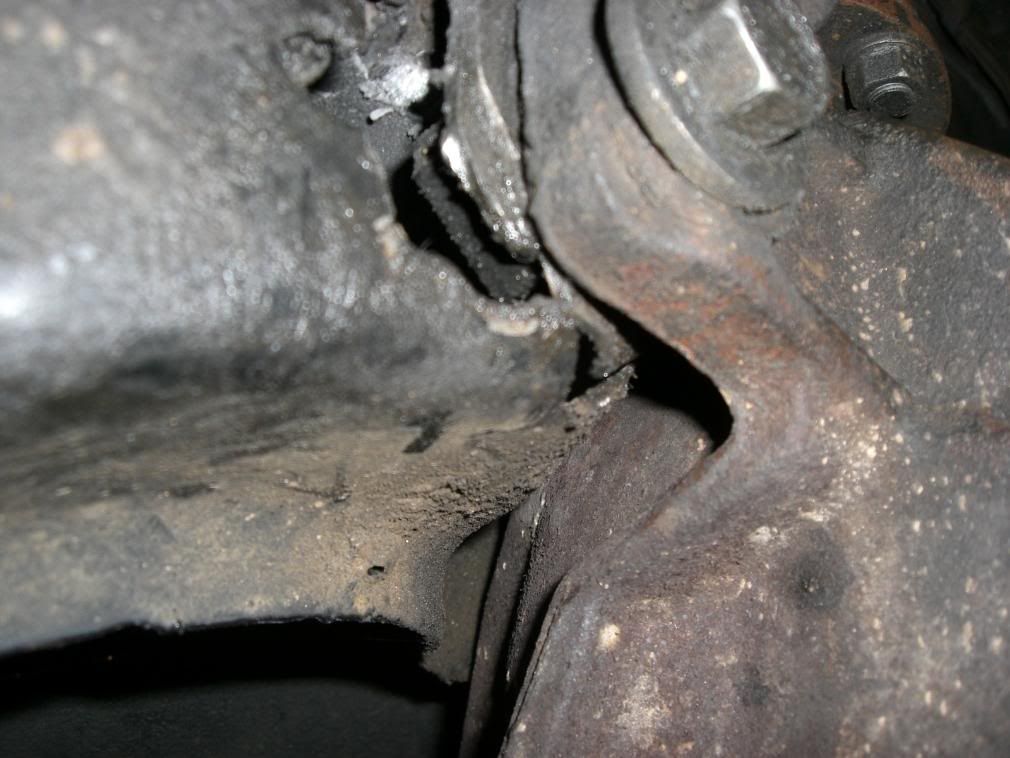

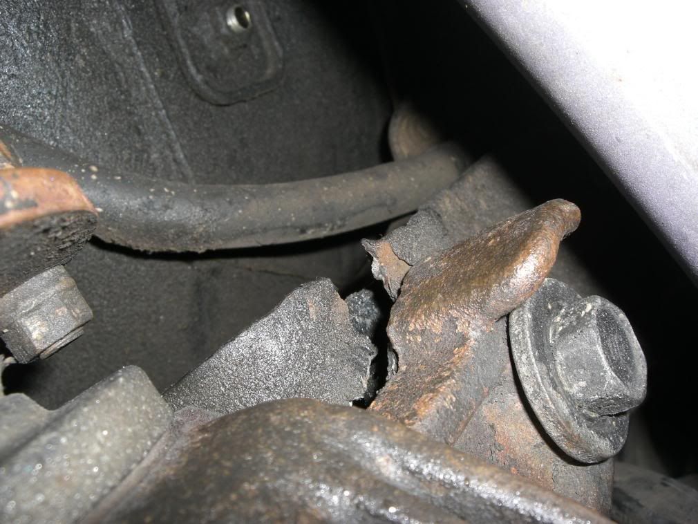

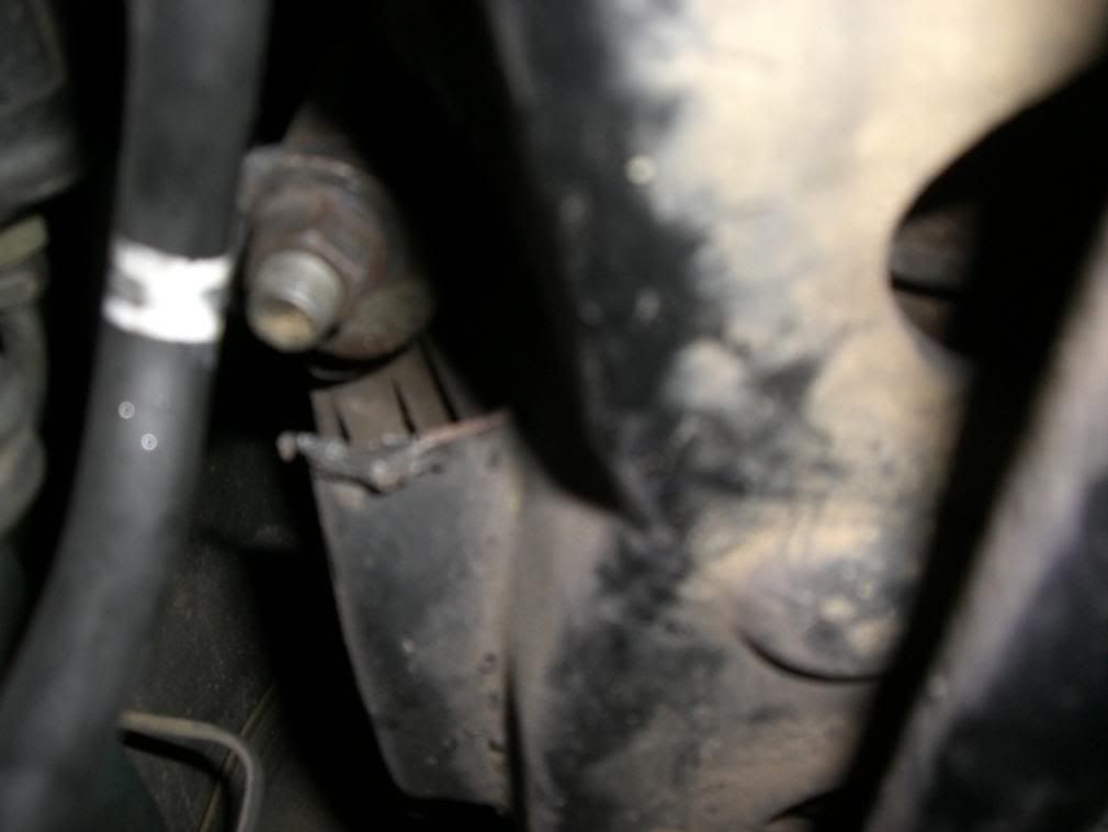

holy SH*T!
guess i need a new sub frame now :aigo::aigo::aigo::aigo:
thats where i saw i broke a bolt... then....
top stud/nut
front mount pass. side :aigo::aigo:
stud again.
Do you think this is fixable?
If i grind the crap off and weld 1/4" steel plates, drill bolt holes, reinforce with 1/4 plates and put 1" round tubing in as cross supports?
Or should i just find another subframe and reinforce the piss out of it?
