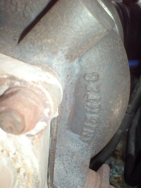

I just zapped my old turbo fins, so I replaced that CT with one a buddy had locally. When we were comparing the two, we noticed a little logo on the exhaust housing that neither of my two turbos had (one from mine, another old one from my Dad's)

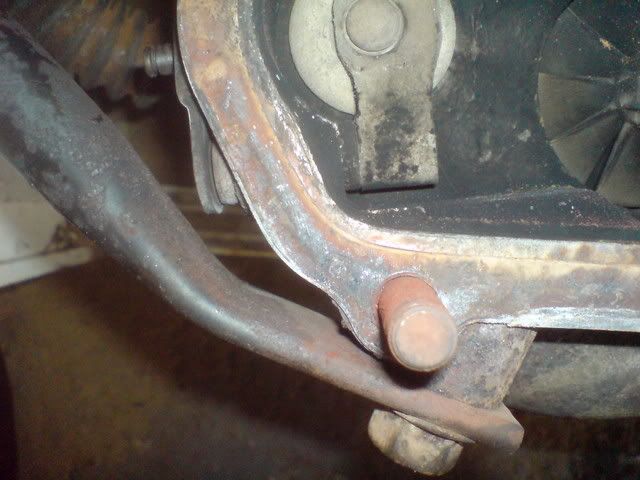

I didn't think much of it until when I was putting the new one back on the car, the support brace from the motor mount ( I think ) ran into the wastegate arm.
Kinda wierd considering the other turbo fit great with the brace installed...
What's the deal with 1: the logo and 2: the difference that causes the support brace not to fit correctly?

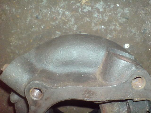

It has a CT26 compressor housing though, its identical to the turbo I pulled off my engine... the compressor fins also look identical to my turbo I pulled off...

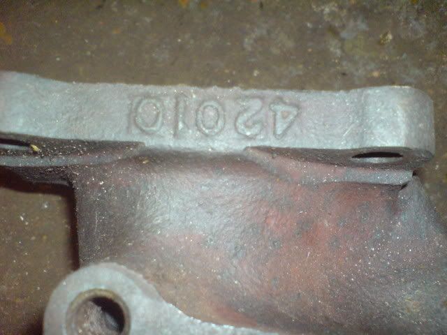

Hmmmmmmmm when I first got my car I pulled the engine and did a refresh. While the turbo was off I noticed the cracks in the housing so got my hands on another housing. When I put the turbo back on I had the same problem with the actuator arm hitting the brace. Will have to look at mine tonight after work. I replaced just the housing so my turbine wheel is stock but possibly in a larger housing??
Just got done looking at mine
Here is a pic of the housing that is on the car, it has AN13HT28 cast on it??
As you can see in the pic I have had to shim the brace by about 10mm to stop it fouling the actuator arm.
This is my spare turbo, as you can see the brace clears nicely without shims.
Here is the housing that I took off, it has noting on it. As does my other spare turbo.
But they both have 42010 cast on them, but the one on the car doesn't
