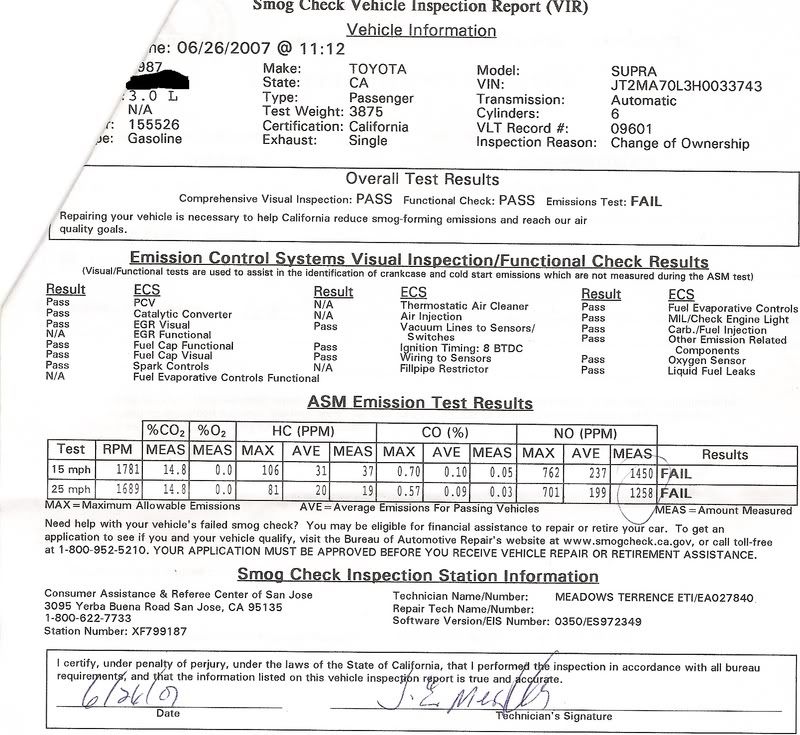

didnt pass smog
mjmendoza
May 7, 2007
95
San Jose
i didnt pass smog through state ref. i have a K&N air filter and 2.5 catback exhaust.. those are my only modifications. any suggestions of why i didnt ...i know its probably the catback system...but is there anything i can do without putting my stock exhaust back on.

Copy the test sheet from the inspection place, and post it up.

there you go

i just got a diagnostic and the results came to...i need a new EGR vacuum modulator, EGR valve, and Vacuum switch valve...if anyone knows where i can get these parts please tell me thanks...

jetjock said:
Yeah, your test results show a bad EGR system. It's certainly possible every component in it isn't working but I seriously doubt it. Unless you removed them it appears you're about to be taken for a ride.
i didnt take anything out..i got this car about 5 months ago..and before i got it the guy i bought it from smogged it and passed...

I'd test each component first. See the service manual. I doubt they're all bad. Could even be they work but the head or other EGR passages are clogged. In fact, since the car passed a few months back that's could well be the cause.
Used VSV and modulators would probably be OK but the EGR valve itself is a crap shoot. I've never seen one that didn't need to be cleaned. They all leak at the pintle shaft seal too. Just my two cents as a former certified emissions guy...

http://www.cygnusx1.net/Supra/techtips.aspx Way to check probably described here.
But, mind if I threadjack? :D I almost didn't pass the test, my lambda was kinda between pass and no pass :) the limit is about 1 and my car had also something about 1. We get tested at 2500 rpm. I don't know the exact numbers, cause we don't get any sheets anymore with :(
Can I get some help from this info?
