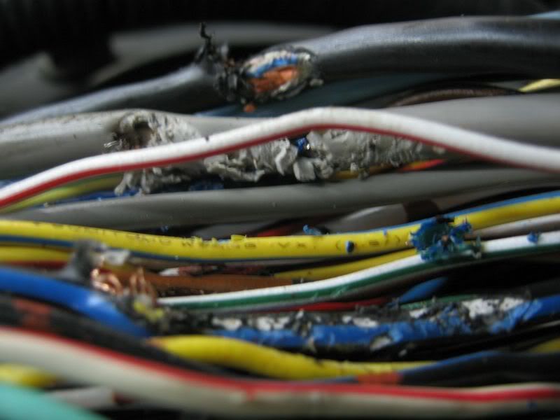

As an update my sensors were both fine, even with an oil coating. The problem in my car was wiring.
That is most likely unlikely on another car but happened to be the case with mine. That is the ecu wiring that goes through the firewall. The worst spot was inside the car about 10 inches away from the ecu.
Food for thought. Check resistance of cam sensors before getting new ones.
