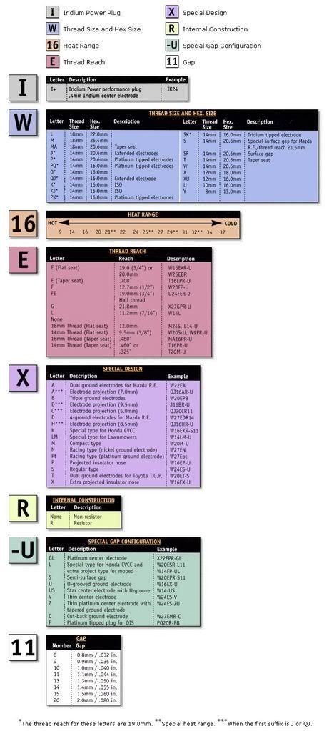

Denso Q16R-U 11 is exactly what is printed on the plug itself. Does anyone know if this is the correct plug or if I'm gonna have to go visit the shop again tomorrow? Also, I noticed some people set different gaps.... I personally was going to go with w/e the TSRM told me. Any specific reason I should go with a different gap setting?

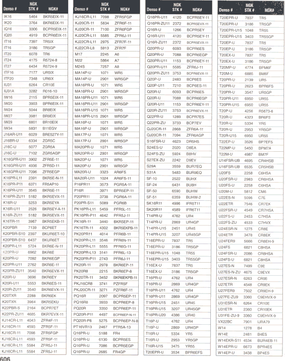

You can research your plugs on www.sparkplugs.com. The Q16R-U11, 3006 - are gapped for an NA.
http://www.sparkplugs.com/more_info.asp?AAIA=&pid=24673
14mm thread, 19mm(3/4") reach,16mm( 5/8") hex, fully projected, resistor, U-groove ground electrode, .044" gap
I think this is what you're looking for.

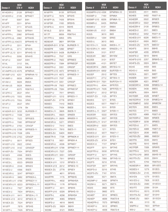

Standard Plugs:
NGK 2330 BCPR6ES 0.032 [DENSO 3007, Q20PR-U]
(COLDER)
NGK 3330 BCPR7ES 0.032 [DENSO 3010, Q22PR-U]​
cross reference
http://www.clubplug.net/denso_ngk.html
