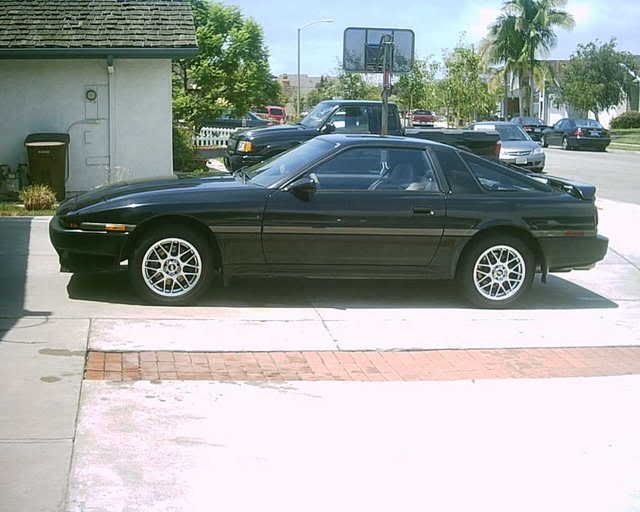

Well i don't post much I'm more of a lurker, been a lurker for a few years now here and on Supraforums. This is about my black supra. It's an 87 turbo 5-spd. I got it around this time last year . Well around late December I developed a slight case of rod knock, reason for this was because my crank pully was loose which i discovered later, the shop that rebuilt the motor before i bought it i guess didn't torque it done properly. I purchased a block from 935motorsports for a steal, and decided to start building that one up until my other one went. Well that time came around late January so i had to get started. My goal is 475rwhp and i have gotten most of the parts but i still have quite a bit to go. It's a slow process but it's coming along.

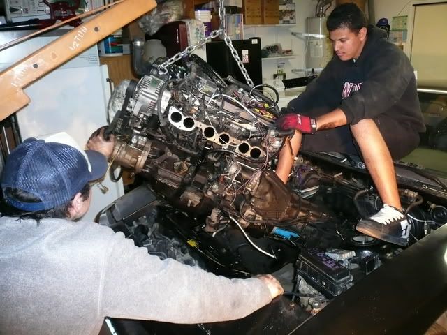

Pulling The Engine (I'm the one sitting on my windshield)

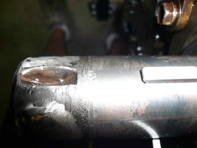

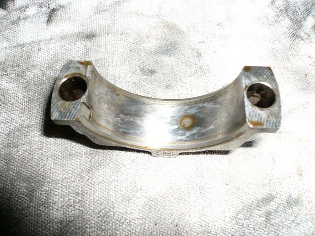

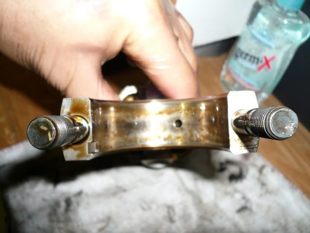

The bearing was completely gone when i took off the #4 rod and the woodruff key was completely shot on the crank....

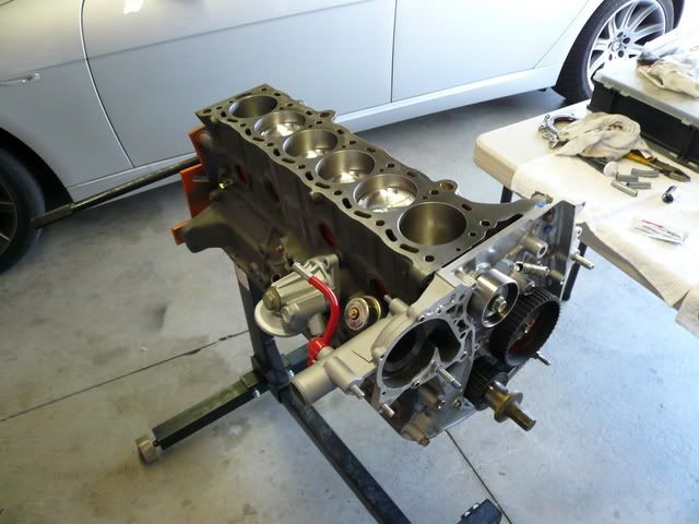

In the meantime while i was pulling my motor i sent the other block and the head to the machine shop:

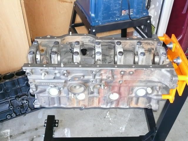

Block when it came back from the machine shop:

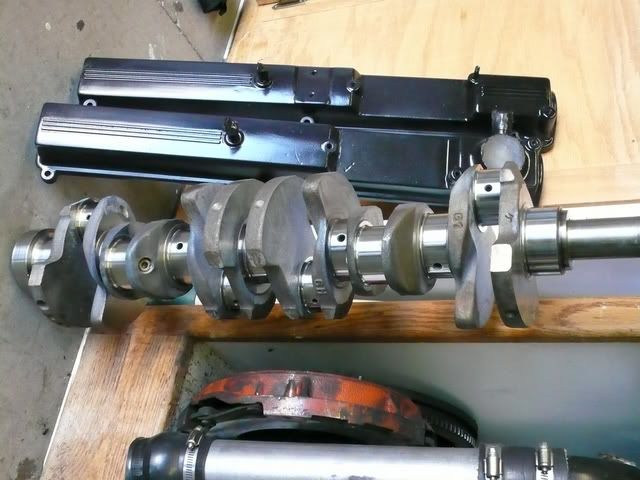

Crank back from the machine shop:

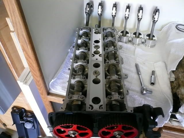

Head Back from the machine Shop:

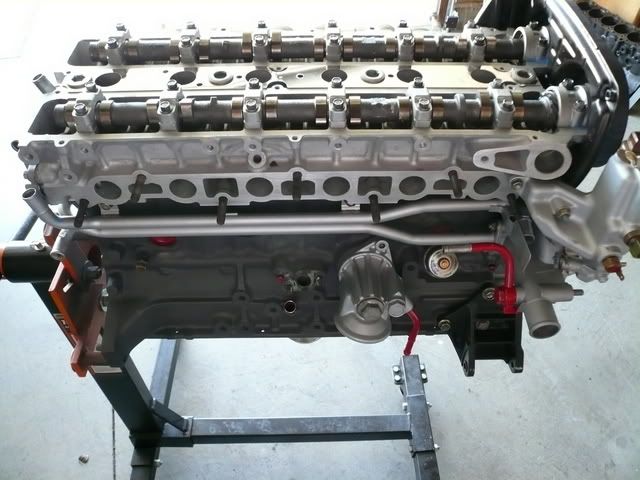

Bottom end put together:
Head Torqued down to 85ft lbs:

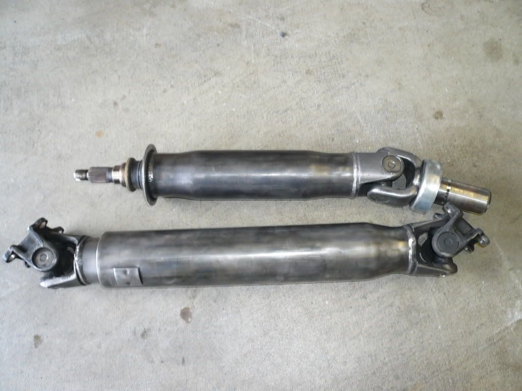

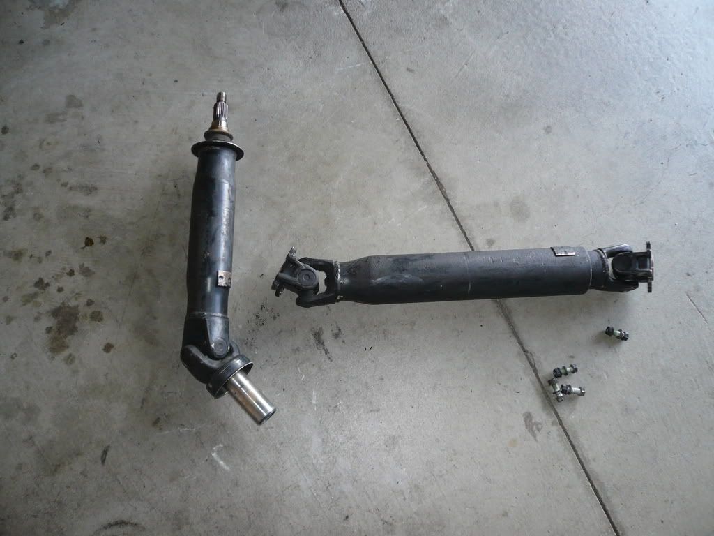

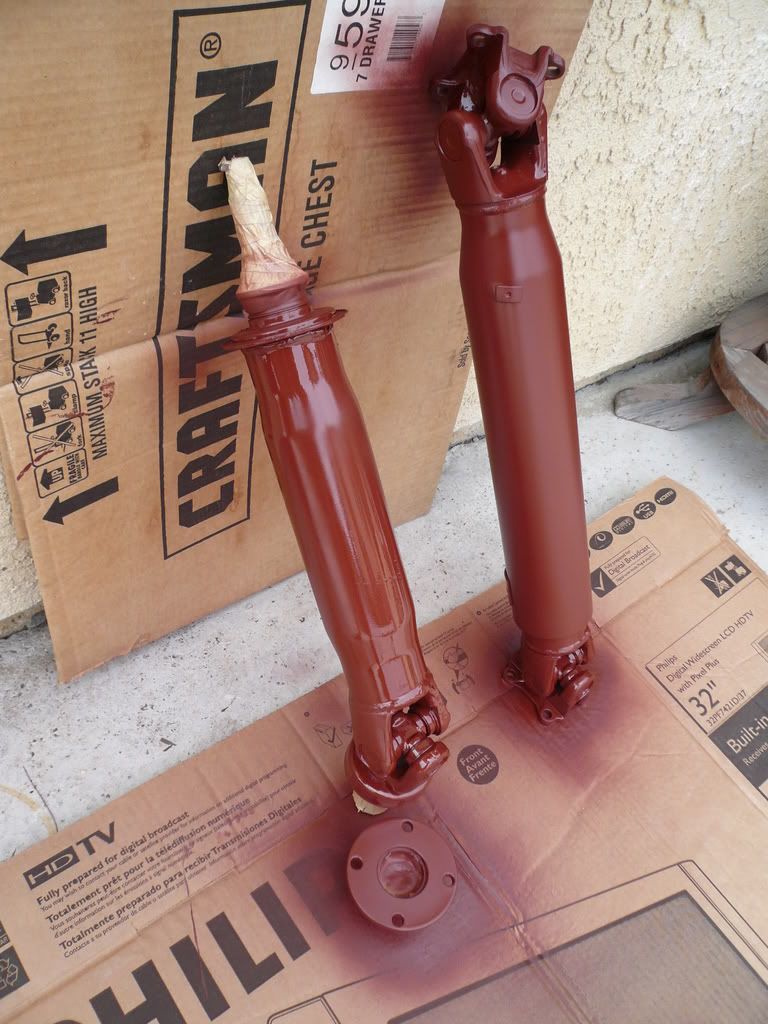

I decided to keep the stock driveshaft mostly for comfort all i am going to do to it is change the center bearing since mine is worn out. I cleaned it up and repainted it, it looks ten times better now.
Half way there:
Pirmer (how it sits right now I'll probably go paint it tonight)

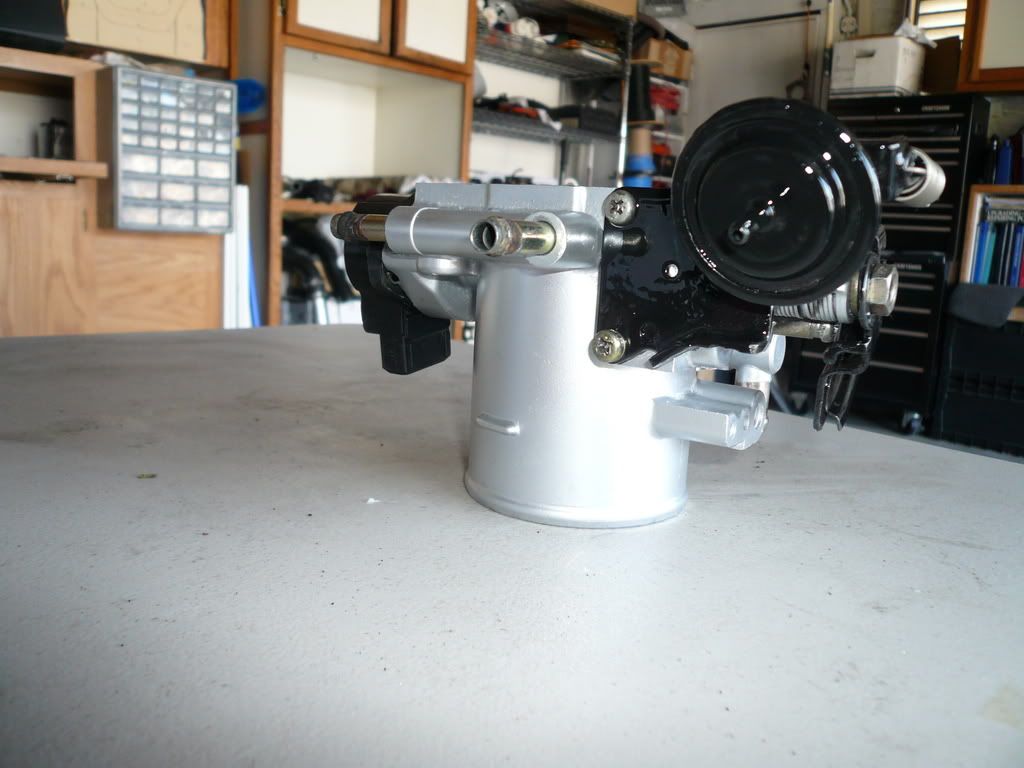

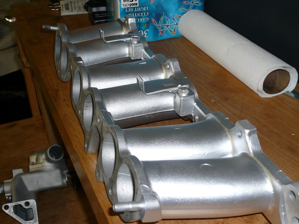

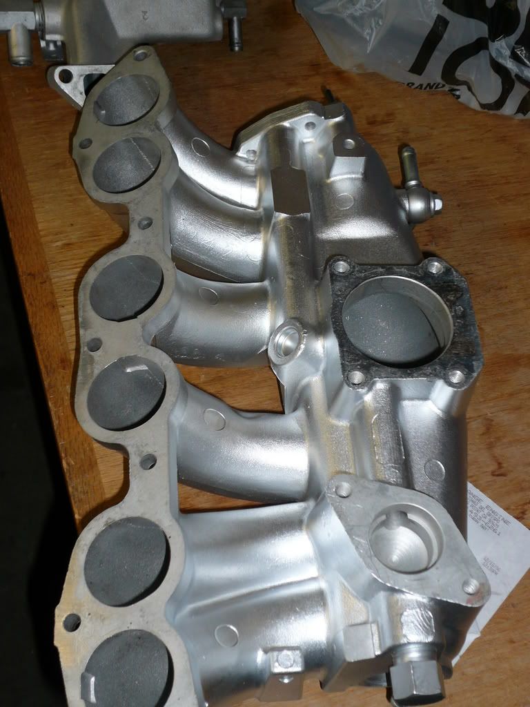

I also cleaned my TB and bead blasted my Intake manifold, they look ten times better.

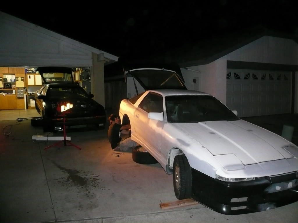

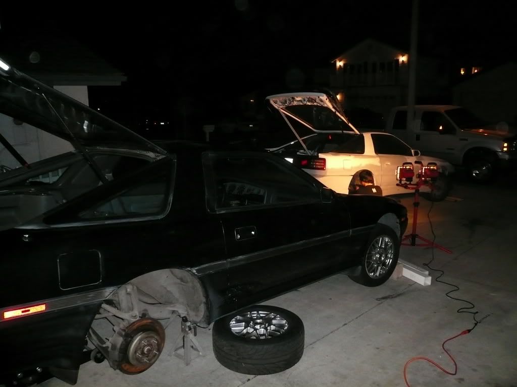

On Sunday I spent the day swapping suspension set-up from my other Supra. (eibacks with KYB struts)

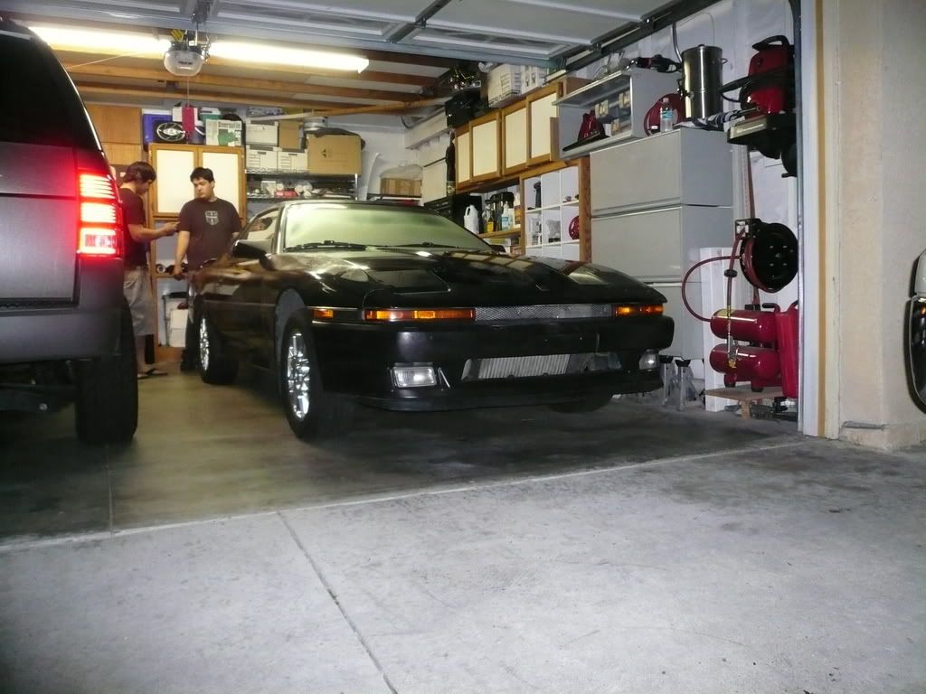

How She sits right now:

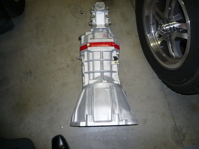

I also just got my tranny back from Marlin Crawler I'll post pictures of it later but they did an awasome job, I would highly recomment them.
Tranny Back from Marlin Crawler
