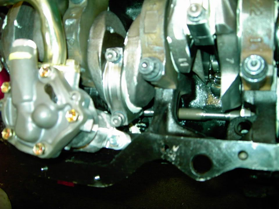

Mine is knife edged. Looks like all they did was mill down one angle on the counter weights. (Still works however, and this allows it to still be balanced even with my rods and pistons.)
Here is a shot of my stroked crank and the knife edge. Also note that the oil pump drive is machined down to clear the Pauter rod shoulders. :)
