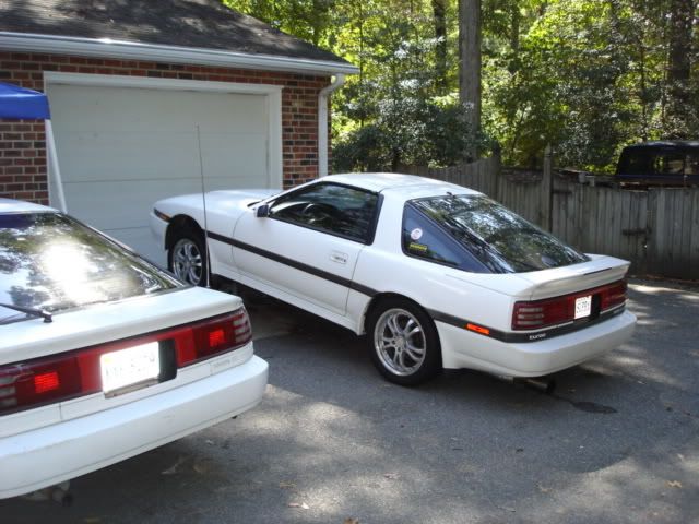

Just got my clutch done last night drove car today, IT DROVE BEAUTIFUL:naughty: if yal didnt know, me and my father just did a 5spd swap> but on to the questions..... i bought a stock clutch kit from toyota, and resurfaced the fly wheel, now i hear ppl say you have to run it 500 miles below boost and 3000 rpms, is this true for a stock clutch??? also i feel like a trucker with the stock shifter throw, whats the best shortsifter out there????? also what looks better black trim out white out package on my car??
btw thats hottscennessey nasty lil 2j in front of me in the second pic right after he finished it , that car is insane:aigo:

Imho....White looks better.
