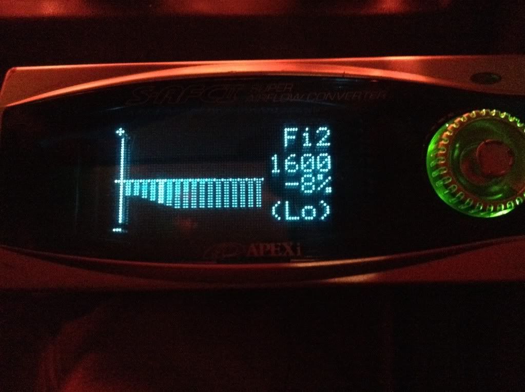

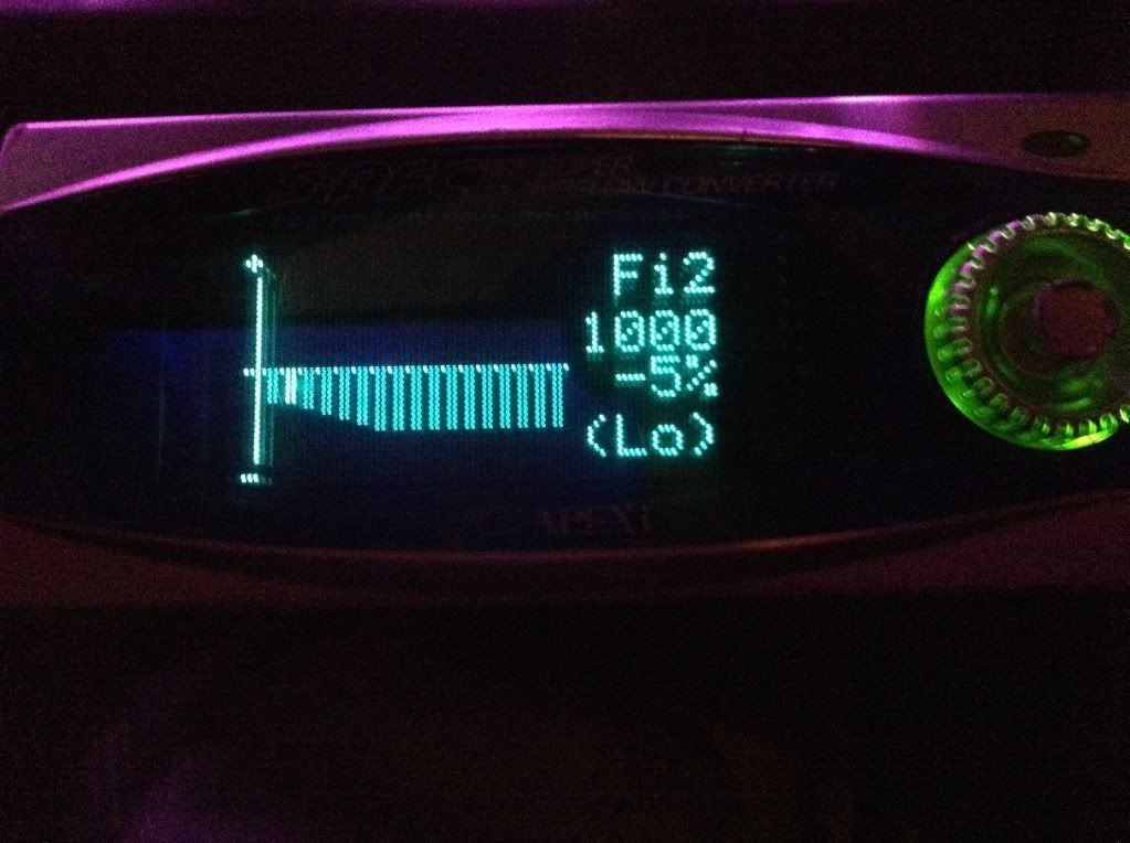

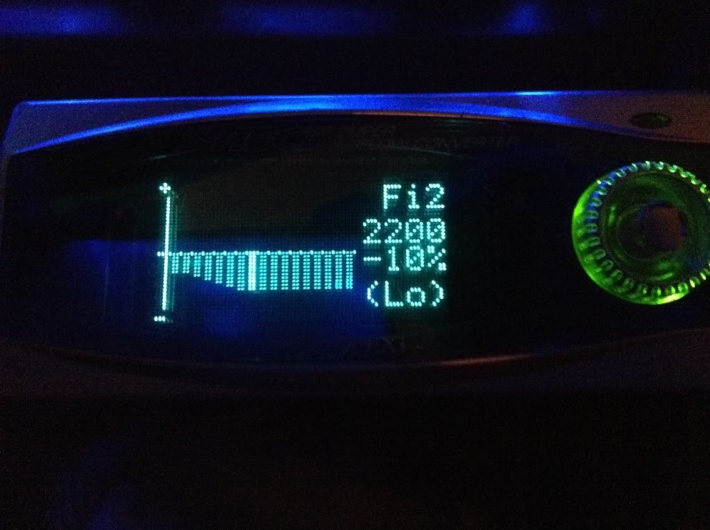

Here's a pic of my SAFC settings. The way it is right now is pretty much dead on for vf's (2-3v at idle and while driving) and the drivability is pretty damn good. Fuel pressure is 35 PSI with vacuum.
These are the low throttle settings for regular driving, I haven't finished tuning WOT.
-10% the rest of the way
