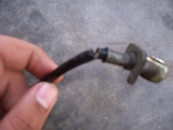

does anyone know how to install the fuel line onto the cold start injector? i ordered another fuel line cuz mine ripped from one end. i've managed to take the old line off from one side (the old line was long enough to use apparently) and when i went to refit it, it ripped from the other end(where it connects to the fuel rail). it seems like the line is very fragile so i was wondering if there is a special tool to help fit it in without ripping it. i just dont want to rip the fuel line i just ordered.
this is where it originally ripped.(thats why i ordered a new one,this connects to the cold start injector)

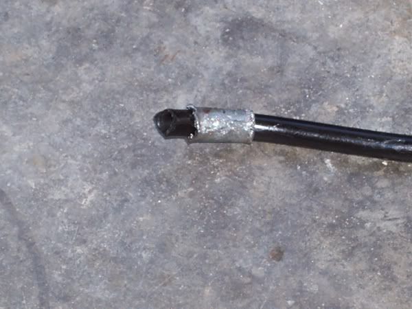

this is where it ripped when i tried reusing the old fuel line.(this connects to the fuel rail.

It goes back on the way it came off. They are banjo bolts, you have one on both ends, washer on both sides of the fitting. You should use new washers the are useally copper, sometimes alum.

oh ok. but theres still the problem of putting them on, it took me alot of time trying to get it off and when i tried putting it back on it just didnt wanna go on. im thinking theres sum sort of tool, but idk.
