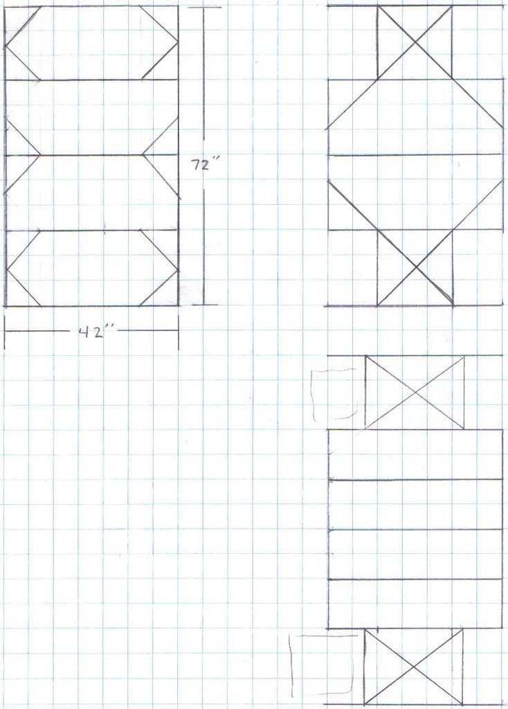

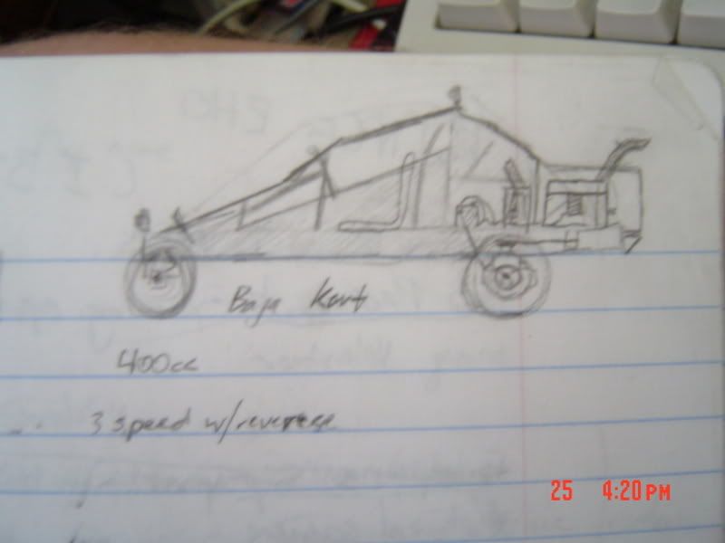

hey h8r, i think we've started something.
heres the plans, scanning more in a sec
dimensions have changed a little, but its gonna look most like the top left frame.

cool. is having the weight so far behind the rear axle ever going to be an issue, or will the frame up front be sufficient to keep weight distribution even?
i wonder how well these trannys hold up.... i want to try and hook up for CV shafts if i can...i dont like the idea of a solid mounted axle. the ride would stink.
