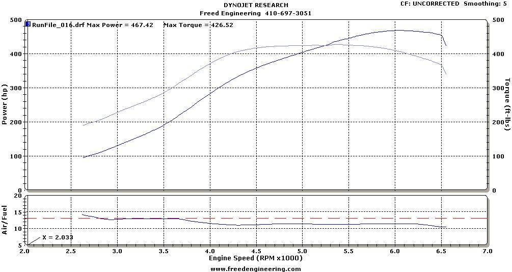

467whp @ 18psi. I'm happy with that. They were going to go for 22psi but electric boost controller started wigging-out and jumping boost all over the place. They powered it off and set the wastegate spring at 18psi and it held steady. Shame because I bet it would have cracked 500whp otherwise.
Powercurve looks really streetable so I'm happy. I'm going to pick her up tomorrow! :)
Few questions:
What's with the low torque numbers? Is it the head port job? Raised cams? 2mm stopper hg? I know this engine was originally built for a much larger turbo, and not a bolt-on for that matter, but still. Maybe it's a good thing since my spec stage 3 clutch is only rated at 450/ft lbs or torque anyways.
