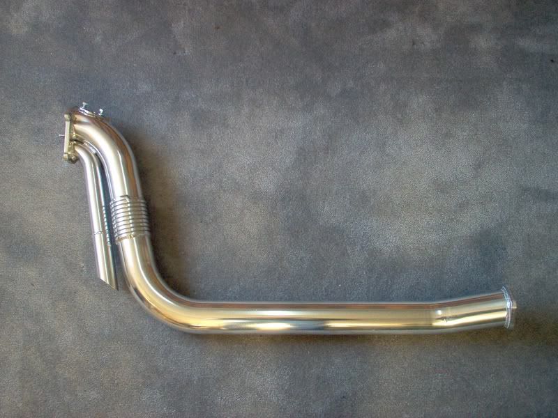

If you go with randys down pipe let us know how it goes. Most the guys that had the problem with these turbos ran the cooleeze down pipe with no problems that I heard of.

I really want to stick with the ddp. Otherwise, any non-divorced downpipe would work. It's just on my BIC DDP, the exhaust/wastegate divider and divorce pipe diameter aren't large enough. Other than that, it bolts up to the hotside just fine. I'm going to call Randy later today to work out shipping arrangements.
