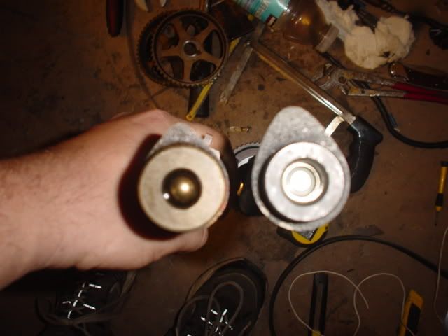

ends up im taking my head off and letting my friend at a machine shop change the springs and shim the cams, hes hooking me up pretty damn nice, he might port match the head while hes at it. but i didnt realize how big these cams were till i put them next to a set of stock 1J cams

thats the exhaust cam, and its a 276
the 268 intake isnt as big, but its still alot bigger
