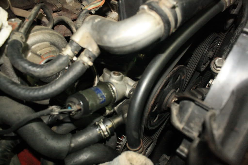

ok so the sensor or something for the radiator fan pump got fried and the fan keeps blowing faster and slower. so im going to exchange the fan for an electrical unit since i cant find a replacement part for the sensor. i was hoping i could remove the pump.
question: can i run a shorter belt without the pulley?
i tried searching and just got ac compressor removal.
any advice? if i could id rather keep the hydraulic unit, but i cant find a replacement
thanks for the help

the 2jz waterpumps fit the 1jz, and the mk4 supra ones take a standard clutch fan, where the aristo 2jz still uses a hydro fan. that sensor may be the same for a 2jz aristo as it is for the 1jz i dont know.
or the mk4 mod is only way to delete the hydro fan setup that i know of.
the pully should swap and thus be same length, as you mean the pully circled in red

this was the sensor i was talking about. so the waterpump is integrated into the hydraulic unit?
i just have to get myself a 2jz waterpump unit then to get rid of the damned thing. thanks allot.
