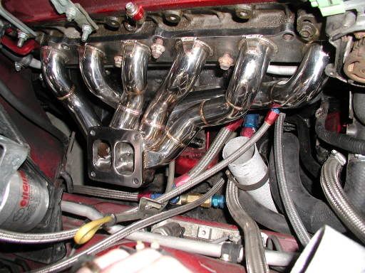

This is the "stock" e-Bay version.
It will not fit any larger turbo without a series of mods, or an adapter plate/mount.
If you want to run the 50mm WG, you will need to modify that mount as well.

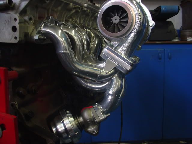

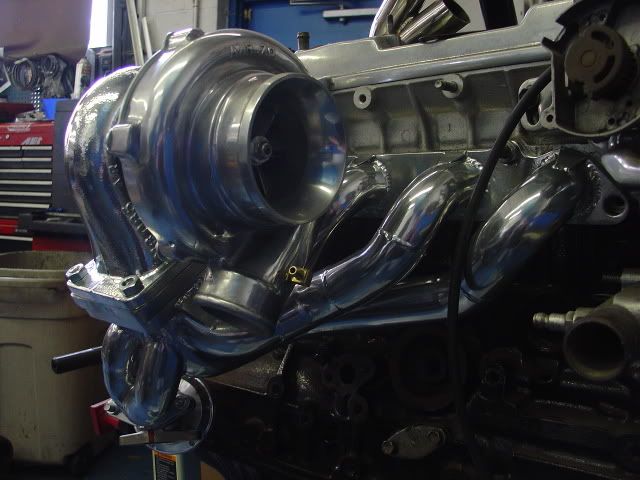

These ebay manifolds are really nice for the price. I would suggest if you go with one of these manifolds get yourself a t4 turbo and a new exhaust to go along with it. I had mine jethot coated along witht the hot side of the turbo. Here is a few pics of mine on my mock up motor.
supra8795
Feb 26, 2006
193
Illinois
Its not that big. It spools around 3 grand and hits full boost around 5 grand. But yeah its been running for some time now. I did 419 hp at 19psi. Im currently running 23psi until i get a new boost controller to turn it up more. Also ran a 12.8 at 15psi with this setup too.
