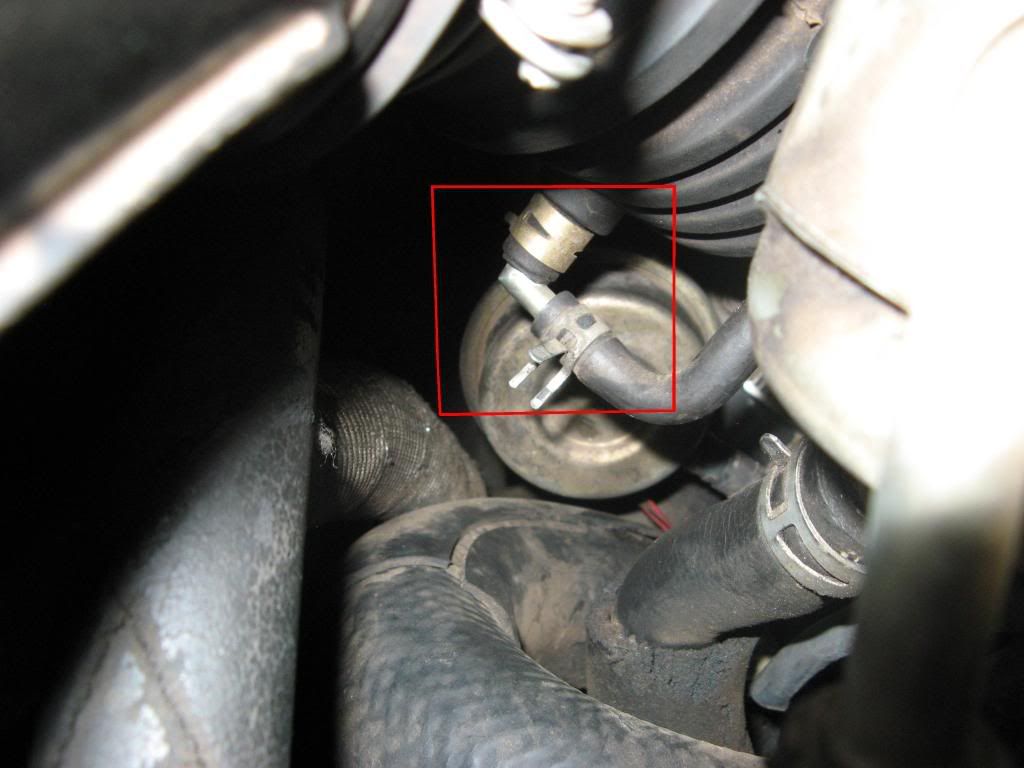

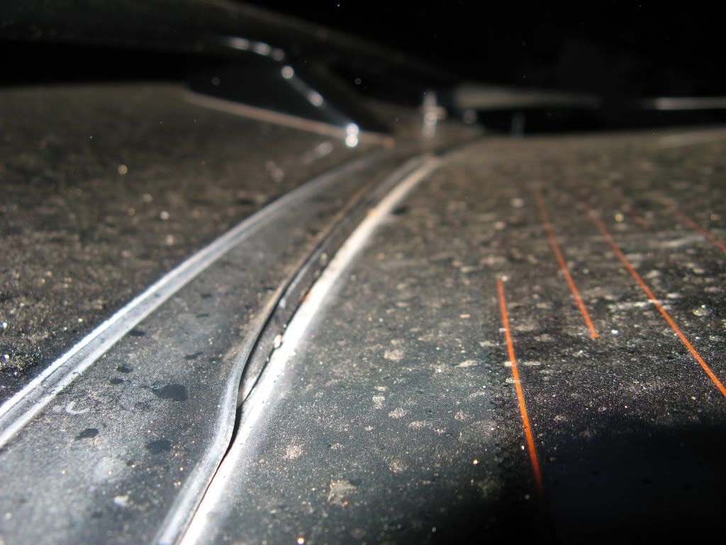

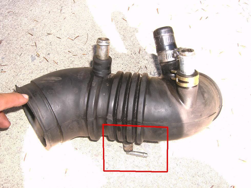

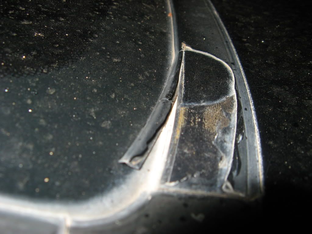

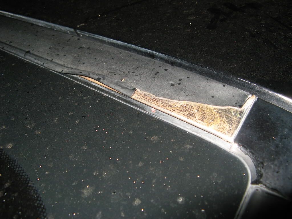

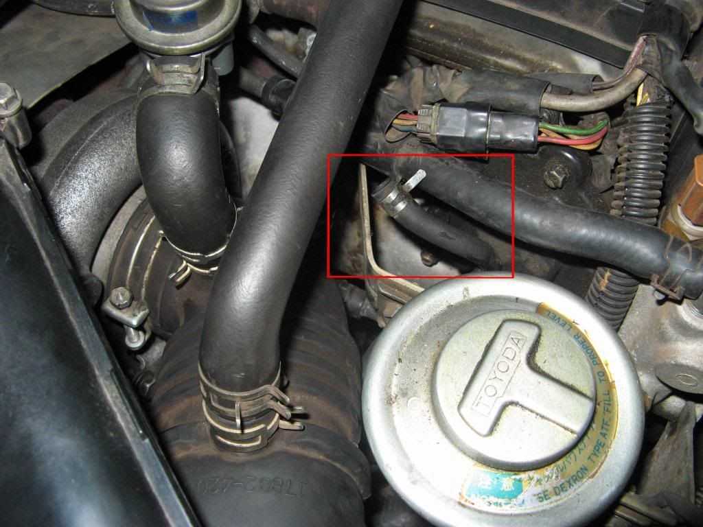

Guys, while stuffing around with my car, pulling bits and peices off and NEVER looking or taking photos of where they came from to begin with, I cannot figure out where this vac line goes to.It comes off the bottom of the intake pipe that goes to the front of the turbo it is about 6-8inchs long. Also I have attached some pictures of the rear hatch seals (top & bottom) . Has anyone ever replaced these seals/bezels.
WHAT CONNECTS TO THIS NIPPLE ON THE INTAKE PIPING?
Top Hose
Bottom Hose
Top Seal
Bottom Seal

the hose i believe goes on the power steering vsv located on the power steering pump. and the molding try toyota or junkyards for a better condition one.

I'm pretty sure it's the Idle Up Device for your power steering. Check out the diagram below.

Errr well my idle up control is still working perfectly even with that hose being disconnected! Could it be from something else?
