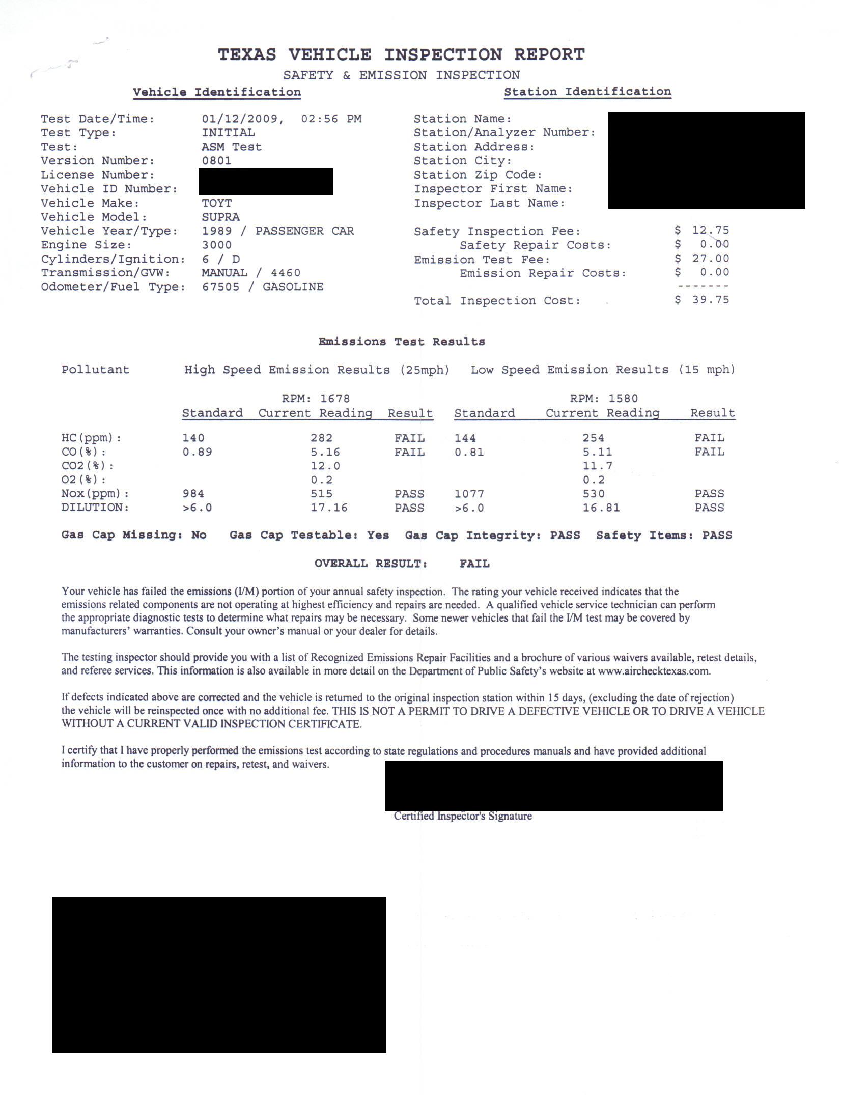

Here is what my results look like. Thanks for any help with tuning suggestions I might be able to make in order to get this car to pass.
Thanks,

It looks to me you are running a bit rich and also picking up some tiny misfires (may not even really feel). I don't know what your tune looks like, so it is hard for me to say what is left on the table before a cat needs to be put in. Careful air/fuel tuning (again the engine should run GOOD), injector timing tuning and ignition timing tuning will be required. If you feel these are as solid as can be, then you may need a cat. Also plug gap being more open (like stock) helps also.
SupraMan1987
Mar 8, 2006
258
Hickory area, NC
Appears as if your CO is off the charts. Lean it out, probably running rich. Also appears you have a very slight misfire. I'd say retard the timing slightly as well.

Geesh...how do you and John see a slight misfire with the information I've provided?
So, do you think simply retarding the timing and leaning out the fuel will get the car to pass?
I'm pretty sure I know where/how to retard the ignition, but not so certain about the leaning out the fuel.
Is there a "Tuning your AEM System for Dummies" book I can look into or can I send someone my AEM configuration and ask for it to be changed for me?

Lean misfire will cause the HC to go through the roof. Lean will not cause CO to go up (correcting figgies post above). CO goes up when the mixture gets richer.
A catalytic converter works great at 2500 and above, assuming the feed gases are close to correct.
The piss poor spray pattern of most bigger injectors (not sure if you have any or not) and more agressive cam profiles make emissions testing a chore. It really depends on your local regulations, as I said before. You also need to really work on the transients (accel/decel fuel) to keep things clean.
Got your email, I can take a look but going to be a bit tricky without being in the car. Passing emissions with a standalone and some mods can usually be done but takes some work and really knowing what is going on as things relate to each other.
