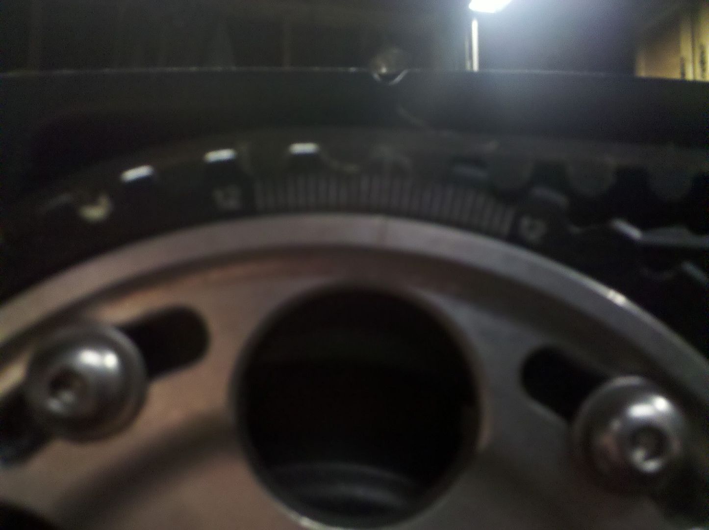

well i did what we talked about, and it ended up i needed to move it a tooth over, its still not dead on but its alot closer than it was and at least aiming at it lol.
i know its blury but it was dark, and cold, and didnt feel like staying out there any longer than i needed to :)
