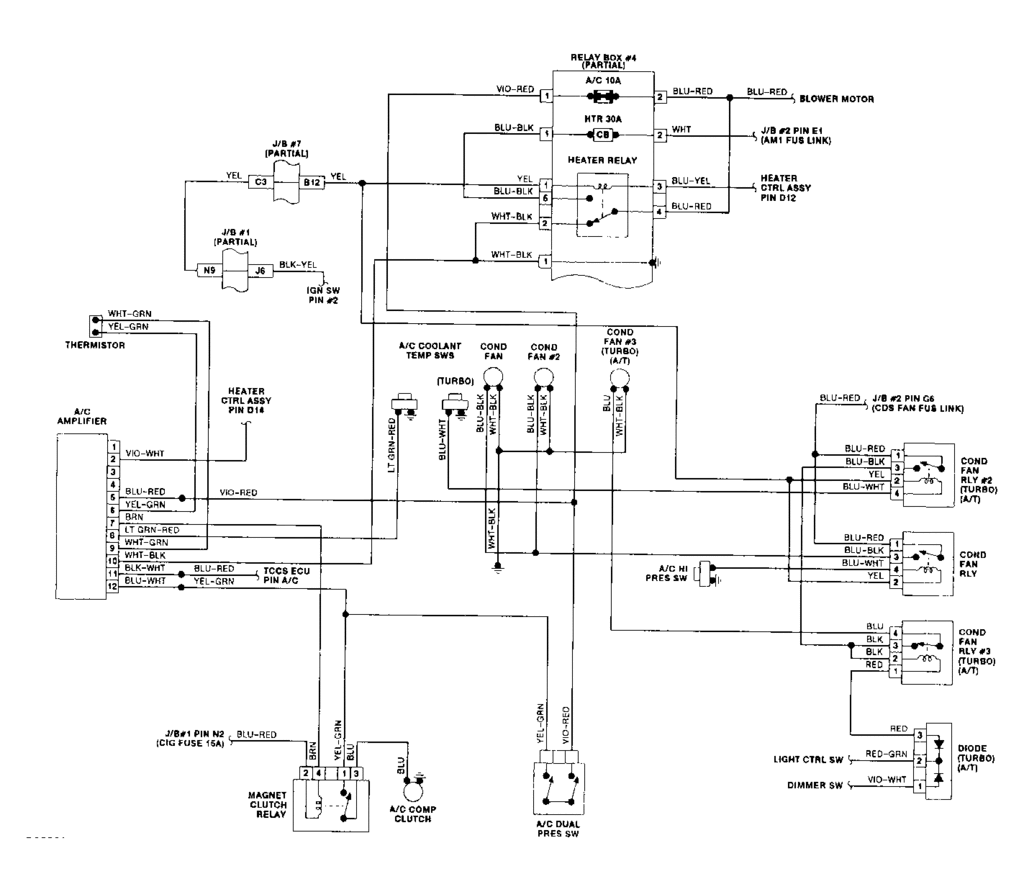

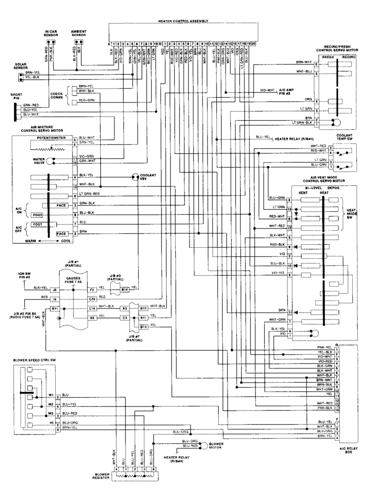

Ac not working look here for wiring diagrams.
metaphysico
Mad Scientist
Jan 2, 2008
428
45
Gainesville, Georgia
Figure I would post this to help people because it is hot and a lot of people have ac problems. I should say first make sure your system has a full charge of Freon before worrying about checking the electrical system. These diagrams are a lot easier to read then the ones you get from the tsrm or hayes or anything else.
