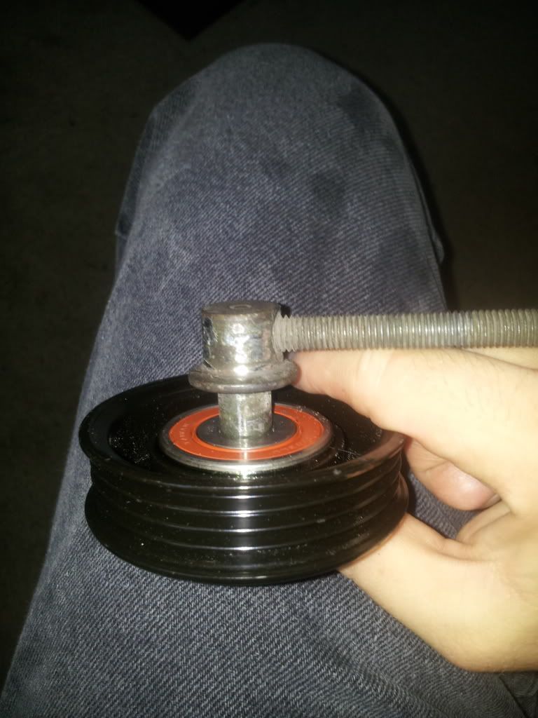

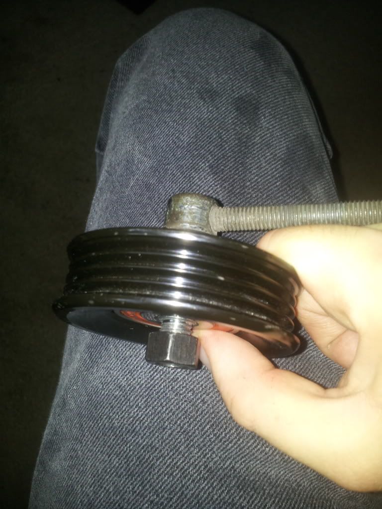

Recently, somehow, the nut for my A/C idler pulley worked itself loose, causing the pulley, and the belt to come flying off as I was driving along. I ordered a new pulley, and I have a nut for it, but it doesn't seem to be fitting right. It seems like there should be a washer or something between the pulley and the bracket it bolts to.
I took a couple pictures. I was wondering if you guys could tell me if I'm missing anything from the assembly.

There's washer thingy and a flanged nut that holds it on. Odd the EPC doesn't show it. Goes on the side the bearing is inserted into. The tensioning bolt enters on the closed side ie; the idler is on backwards in the second pic.
Look here:
http://tinyurl.com/d6pe88n
Anyway, you want the inner race fixed to the bolt rather than have the race try and rotate around it. That's what the washer thingy does.
