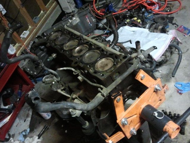

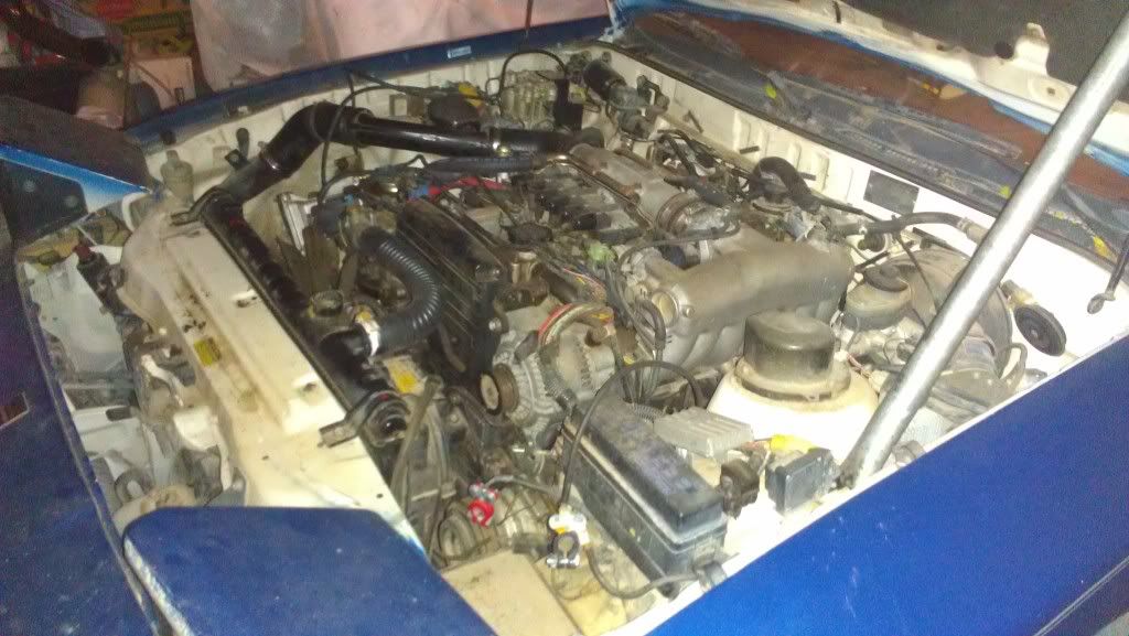

After months of owning the car I finally took action on my supra's knock. I pulled the 7m out and going to figure out what is knocking (even though its an obvious rod knock)

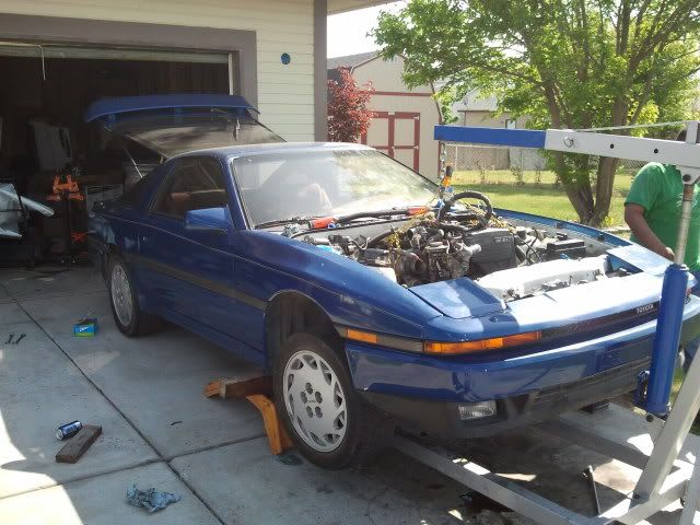

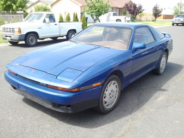

Here lies the victim. . . I mean supra for surgury

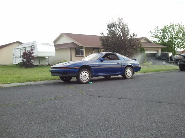

We're getting there

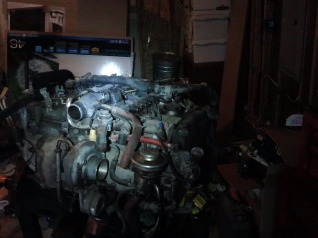

And success, my dad stands victorious next to the 7m

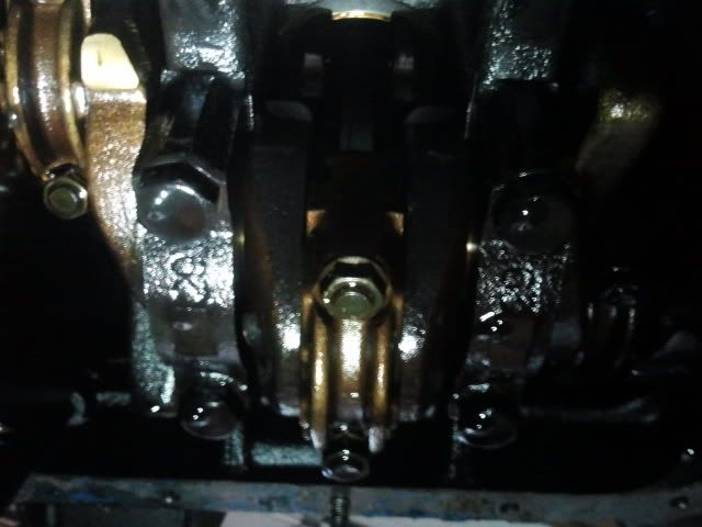

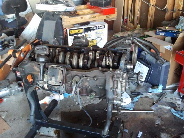

How my motor lies, needs a lot of work

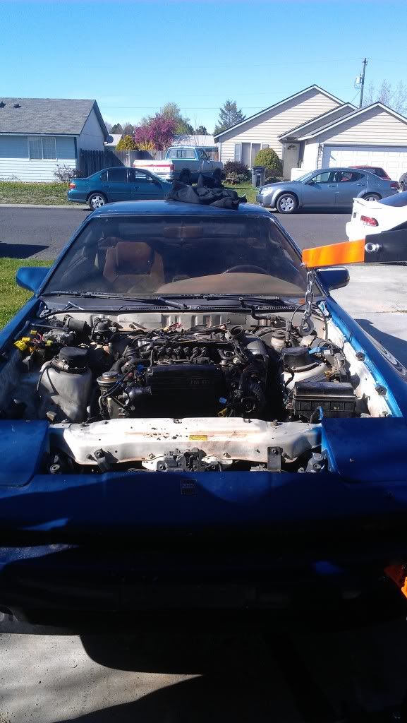

The victim...I mean supra as it rests

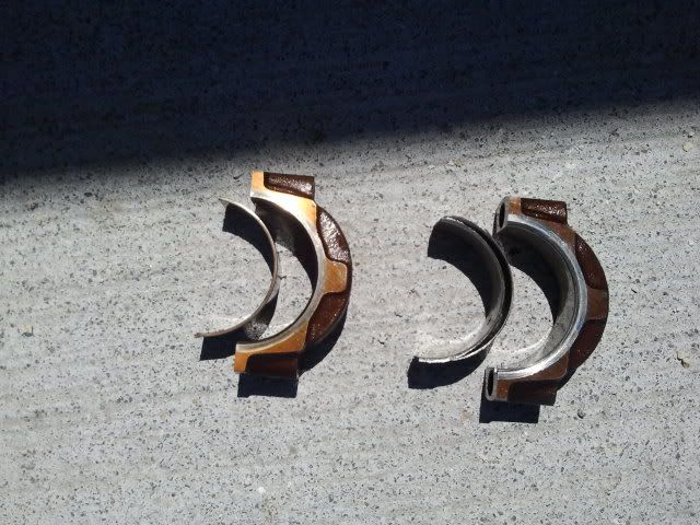

Is that coolant on the rod bolts? Prolly knocked from a bhg.
Good luck on the build.
Id machione the block and head for a mhg. make sure the rear timing cover is bolted on when the block is machined.

Indeed it can. When water mixes with oil the oil pump will suck up the water and feed it to the bearings which will promptly destroy them for you. So nice of the hg to do that to you right. lol.
Pretty common. Even people who fix the hg half the time they drove on it while it was mixing and possibly didnt know it, and after about 1k+ miles it will start knocking on them. Its a pain.

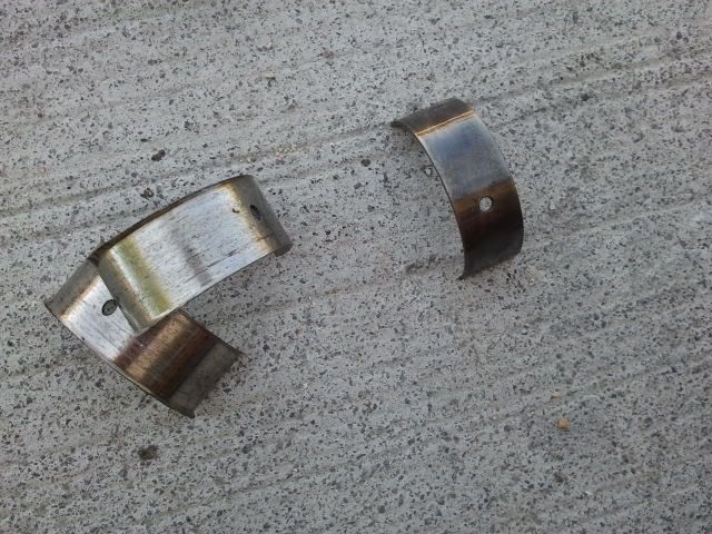

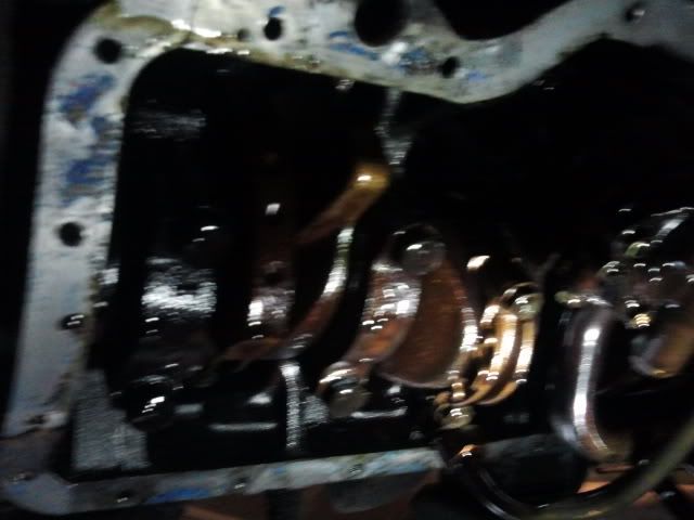

ok lets play a game!! Yay! lol
can you guess which bearing is broken?
2nd hint....Theres only 2 bearings there

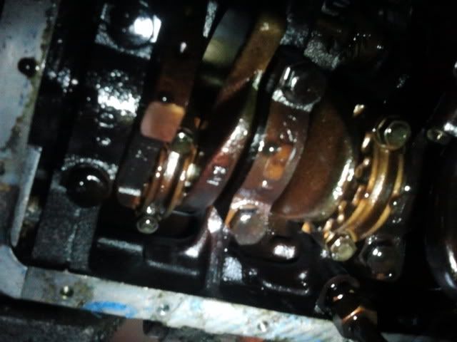

Now this is the crank
sorry for the delay, I don't have a computer and phone is too slow

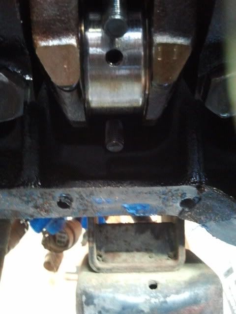

Heres my new crank provided from a forum member (forgot his name)
Set the rings up and slapped in the pistons

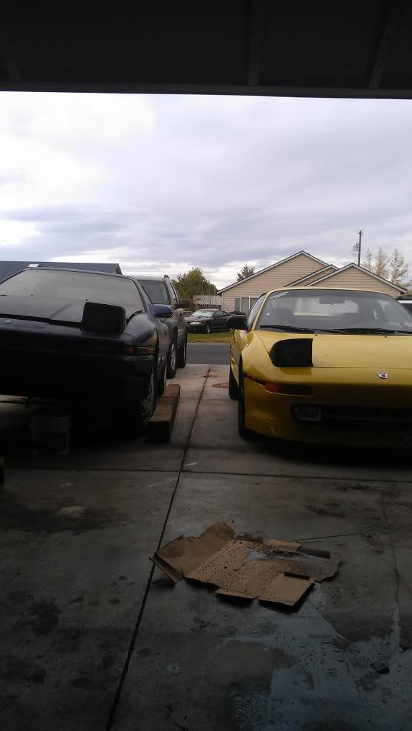

Here she rest with her buddy my MKII
